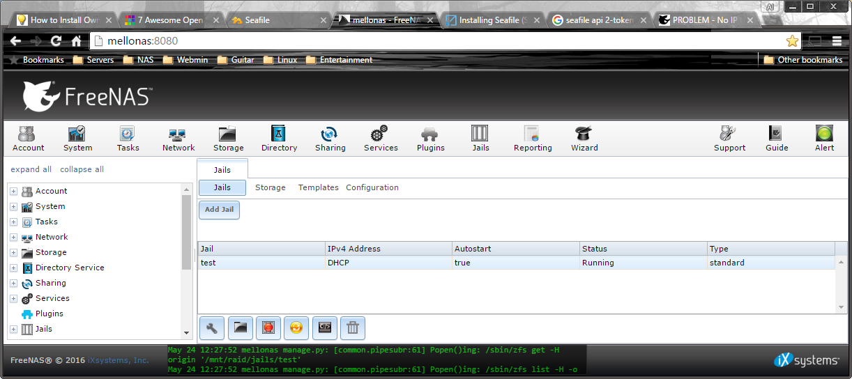

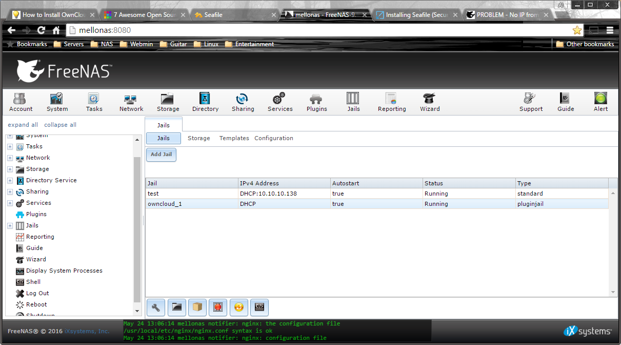

But the GUI doesn't show any IP, just DHCP under IP Address (although if config on the shell does show the same ip above)
melloa
May 22, 2016
1,749
upload_2016-5-24_12-46-26.png The GUI
D
dlavigne
Guest
That is correct. It will only show an IP if you manually set a static IP, otherwise it says DHCP.
melloa
May 22, 2016
1,749

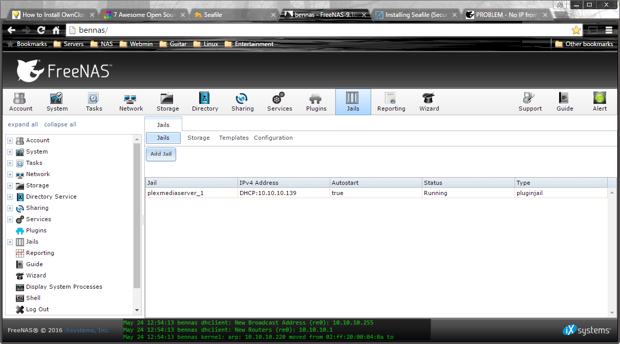

Not sure. I always saw the IP besides the word DHCP. See my other FN that I didn't delete the jails:
melloa
May 22, 2016
1,749
That one is running:
Build FreeNAS-9.10-STABLE-201605021851 (35c85f7)
Platform Intel(R) Core(TM) i5-2500 CPU @ 3.30GHz
and mine:
Platform Intel(R) Core(TM) i5-4430 CPU @ 3.00GHz
So same build.

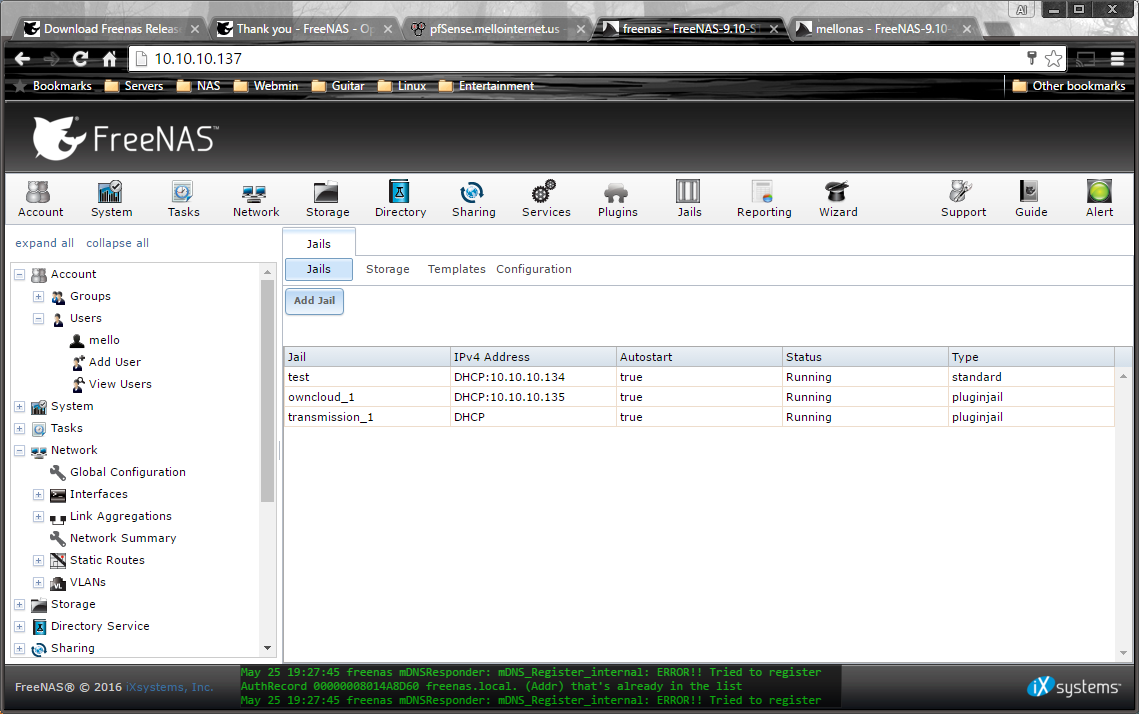

melloa
May 22, 2016
1,749
It came up after awhile. See screen. Also installed a plugin to test and no IP on GUI or shell.

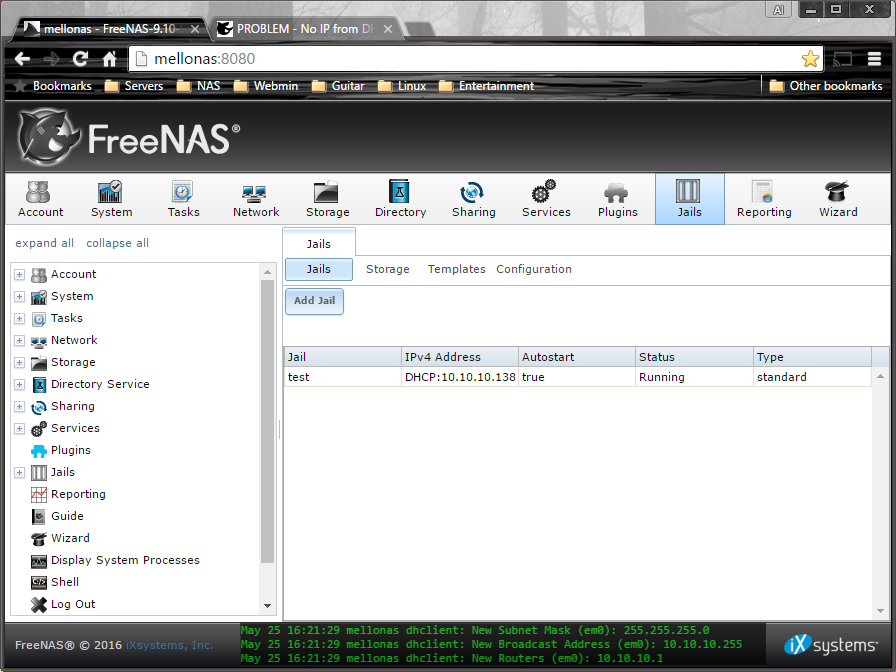

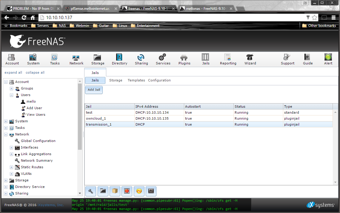

As requested:
Fresh install
- Regular jail created and obtained IP from DHCP
- Owncloud plugin installed and no IP
- Manually assigned IP
- Changed back to DHCP
- Jail kept same IP previously assigned​

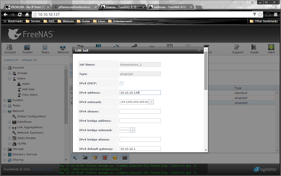

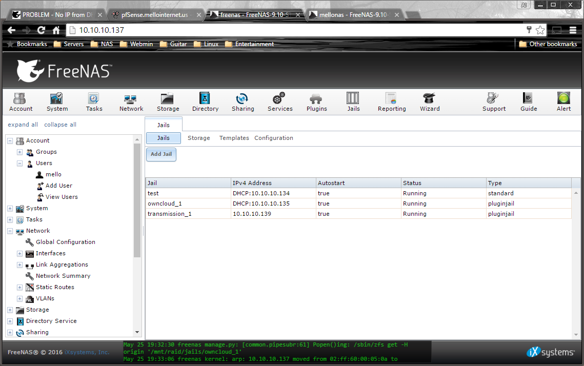

- Installed Transmission to capture screens
- No IP after installation

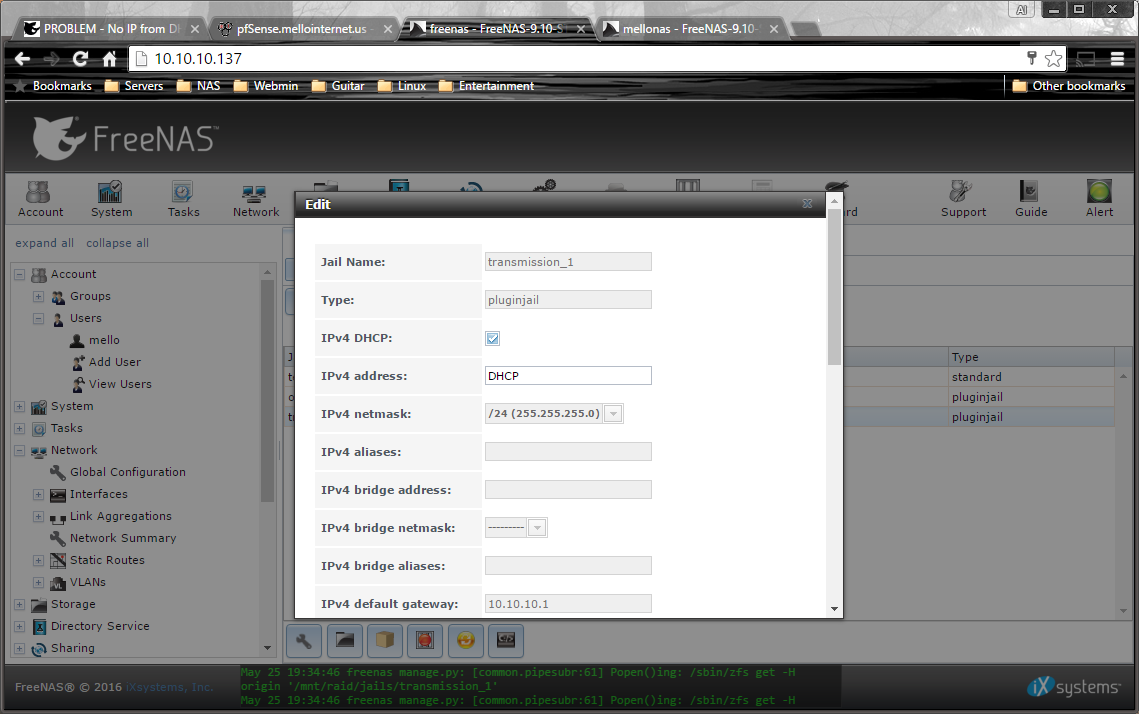

- Manually assigned
- Opened config for it and GUI has changed to DHC
- Saved and restarted -> No IP
- Some errors

This is a LAB box, so I can test anything you guys like.
FYI: I won't be close to the computers from Thu 'til Sun, so my replies will be delayed during that time.

Going to shell to force renew
root@mineos_1:/ # dhclient epair2b
DHCPDISCOVER on epair2b to 255.255.255.255 port 67 interval 3
DHCPOFFER from 10.10.10.1
DHCPREQUEST on epair2b to 255.255.255.255 port 67
DHCPACK from 10.10.10.1
bound to 10.10.10.124 -- renewal in 3600 seconds.
root@mineos_1:/ #
