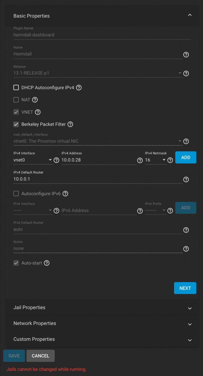

If I set a manual IP address, I can get it to start, but I see some odd behaviour:

  • My default gateway is a Unify Dream Machine SE on 10.0.0.1
  • My subnet is 10.0.0.1/16
  • My TrueNAS instance is called "kserve", on 10.0.0.21
  • My jails are usually on 10.0.0.22 and 10.0.0.23, but I moved them to 10.0.0.28 and 10.0.0.29 as a trouble-shooting step
  • I'm running TrueNAS CORE 13.0-U3.1
  • I'm not sure if it makes a difference, but this Truenas instance is virtualized inside on a Proxmox virtualization server.

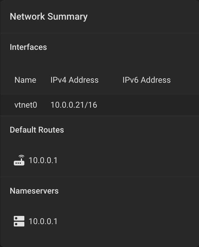

    • Network Summary

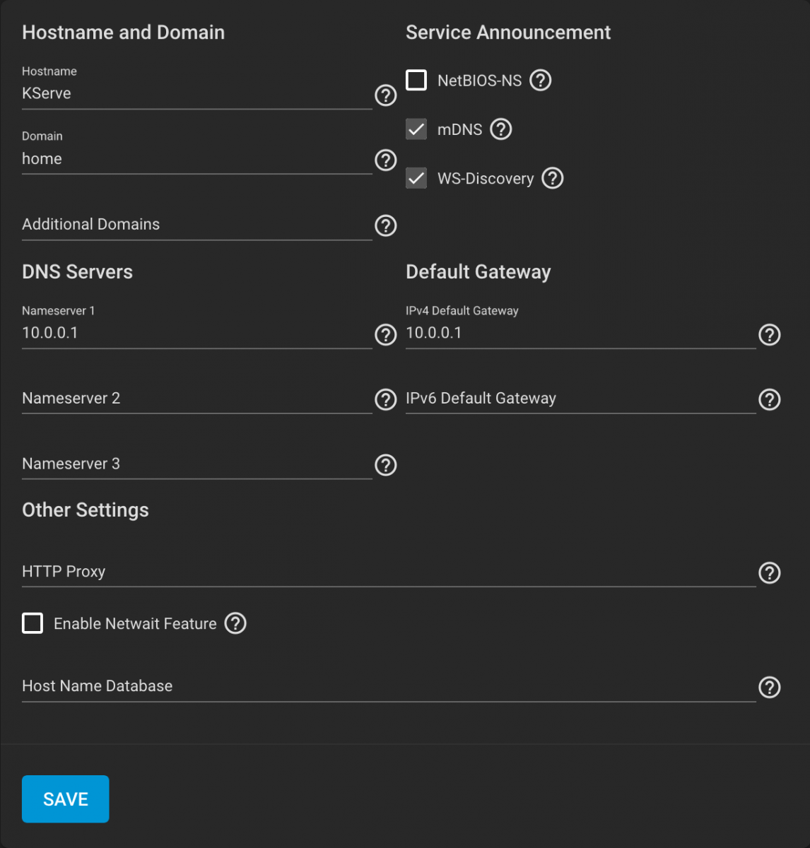

    • Global Configuration

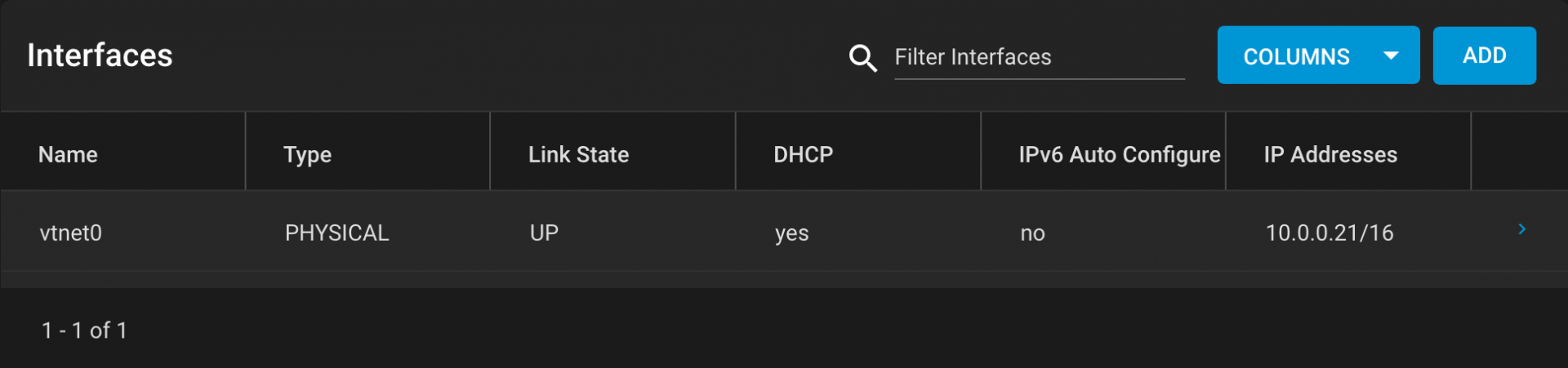

    • Interfaces
