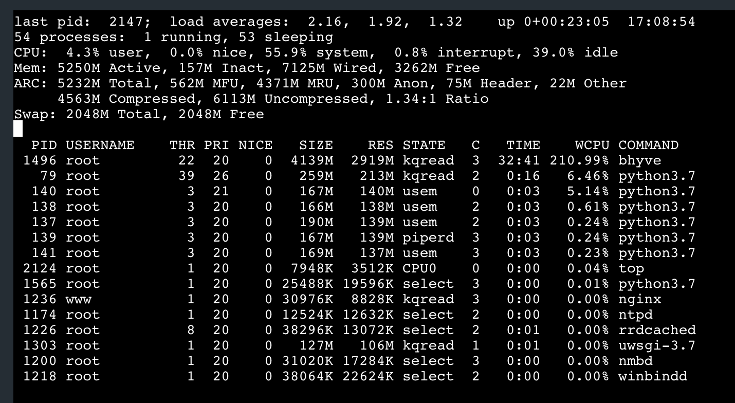

Hi again,
I did some research but was not very successful... but found out, that also the cpu is busy due to bhyve. Does this help to guide me to the root cause and hopefully a solution?
It is not (only) the wasted energy I would like to reduce it is also the sound of three discs I would like to reduce :).
Thanks in advance
Alex 902

Well first of all most people do not spin down their drives. It causes excessive wear and pre mature failure of the drives. It can also be argued that spin up of those drives uses more power than just constantly running.
Secondly bhyve will probably always cause your disks to be spinning. The VM will always be doing something. Even if the os is idle.
Third, your system dateset is on your pool most likely and that will keep your drives spinning from logs getting written and reporting data.
Over all don't worry about your drives spinning down, you are focusing on the wrong thing. Make sure you have scrubs, smart tests and emails reports set correctly.
