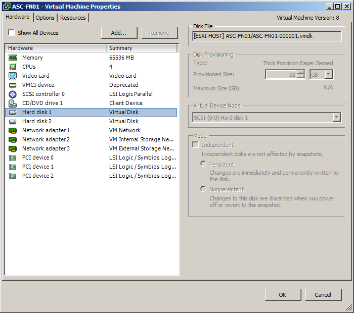

Here is a screenshot of my FreeNAS VM settings on ESXi for reference:

Can you elaborate on the steps you took to create the Virtual Disks? Should be pretty straight forward though, but just double-checking.

Also, note that I run all my VMs as "Version 8" and not "Version 11". This is due to running over version 8 imposes some limitations that you can do via the Client (if I recall correctly). So to avoid any issues I never go above 8.
Would it be reasonable to migrate to a version 8 VM by giving it an existing boot disk created for a Version 11 VM?

TBH, I am unsure. Maybe if you used VMWare Converter you could, but that would ensue too much work IMHO. Just backup the config, recreate the FreeNAS VM and upload the config.
For reference, when I did mine I set the following stuff during creation of the VM (in no particular order, just from memory)
OS = FreeBSD x64
SCSI Controller = LSI Logic Parallel
Virtual Machine Version = Version 8
OS = FreeBSD x64
Thanks, I'll give that a try tonight.

I have successfully migrated to a scsi virtual disk for boot media and I expect this will solve the problem. Thanks! I will update the thread when I have a conclusion.
I've decided to stick with vm v. 11 until I identify a specific need to change.
