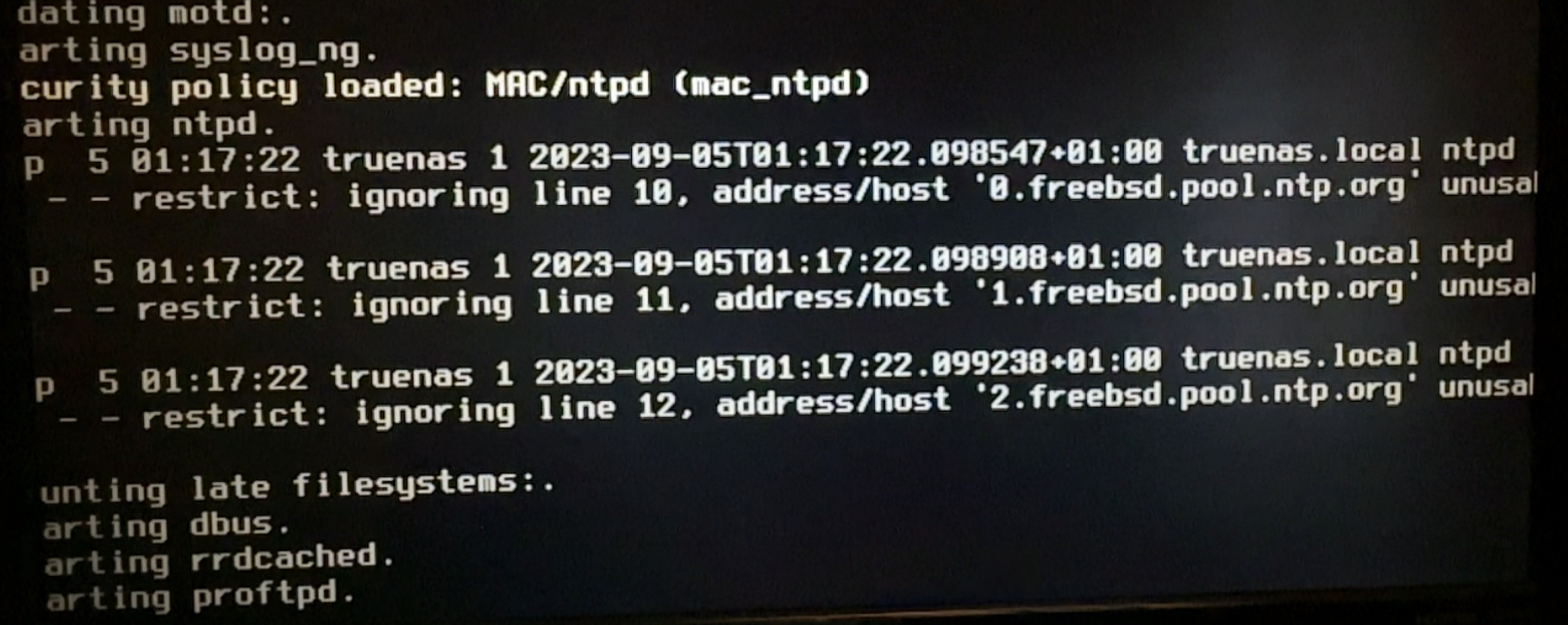

Here’s a poor photo on the monitor I don’t usually use. Can’t access the other one at the minute.
Also, spotted this as I was letting it boot…
Upon booting, I never used to have most of what’s coming up. It was quite clean in comparison.

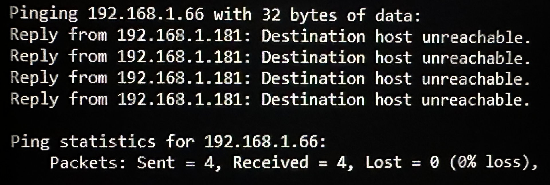

Trying to ping from the NAS did nothing, unless I did it wrong.
From a laptop to the NAS, 4 packets sent and received. What’s the “destination host” though? Is this suggesting that it’s struggling, the. Suddenly works?
As for a rough diagram of the network, I don’t think I understand what you mean sorry.
The router is connected to a booster via Ethernet which connects to two others in the building. One of those is in my room and the NAS is connected to it via Ethernet. As is my Apple TV which has no problems with signal. No other wired connections involved on the network. Plenty of WiFi connections, but they’ve always been there so nothing different.
A fancy way of saying "the other machine". That's weird output for ping, which contradicts itself, not sure what's going on there. Do note that you'd want to ping a different machine, not the NAS itself.
Aha, thank you. From the same laptop to another laptop no contradictions when doing a ping test. All went well and very quickly.
