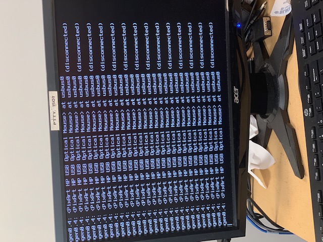

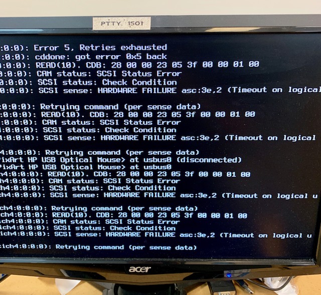

Hi. I don’t really know how to fully describe the errors so I will attach screenshots. The first is the error I get repeatedly. I let it run overnight to see if it would work past it. Got a second error (the one listing the mouse).
I’ve tried two different versions, via optical. I removed all 4 of the hot swappable drives, so they aren’t part of the issue.
It would help to know exactly what hardware is in that thing.
