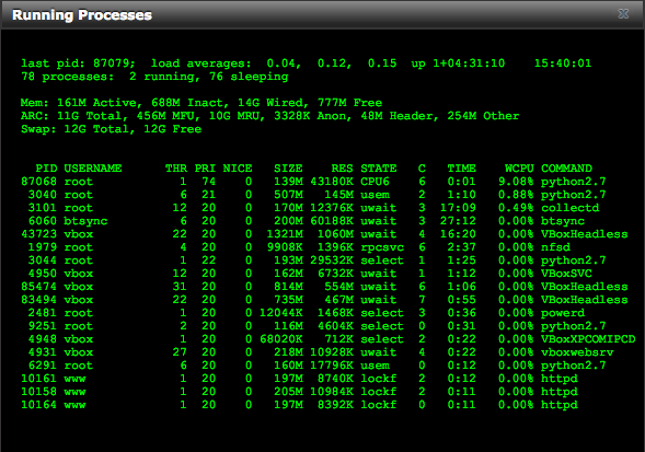

I am. Each VM is allocated 512MB. Usually only 1 is running, but sometimes I fire up 1 or 2 more for a while. They are used as local web servers for in-house development, never more than 2 simultaneous users.
Your question leads me to expect that your response will be to say my system is inadequate, but maybe I should just wait and see.
Here's how it looks right now with 3 VMs running:
The MFU/MRU ratio looks bad because I just dumped a couple of DVD images onto the machine.
Edit: I forgot, last night I created a VM with 1GB of RAM.
