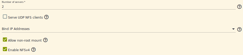

Strange, because I have it enabled in the GUI:
I'm not sure what will happen if I just change rc.conf, but I suppose it will get overwritten by the next reboot.
