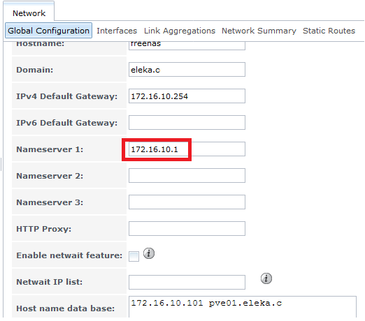

Step one, we need to get everything in a sane configuration. FreeNAS is not a DNS server, so you should point FreeNAS to your primary DNS server.
The thing is my DNS server is also my PDC which is virtualized in Proxmox as a VM, but as any VM or CT do autostart, when FreeNAS trying to reach 172.16.10.1 with a DNS query it doesn't find it because the PDC is down. Anyway, I have already added 172.16.10.1 (DNS and PDC) as primary DNS server on FreeNAS as follows:

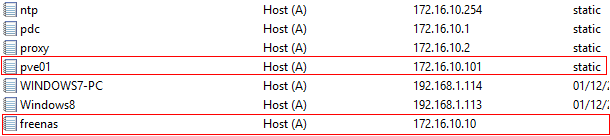

Step two, we need to get DNS entries on your primary DNS server for your servers: Proxmox and FreeNAS.
Done on my PDC which runs under Windows 2012 Server:

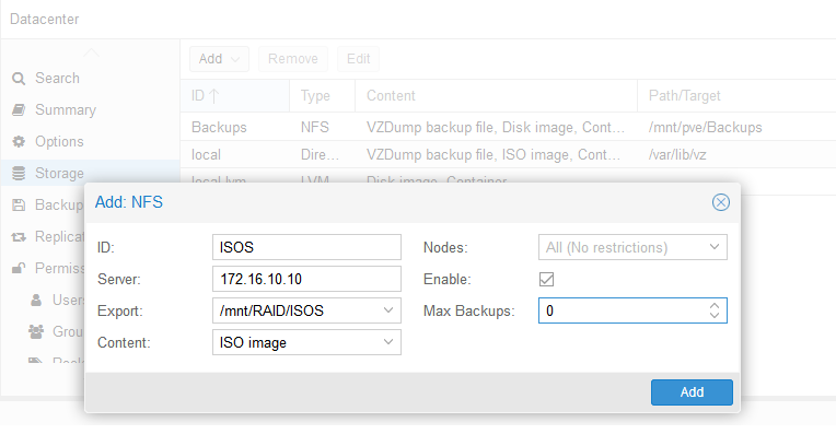

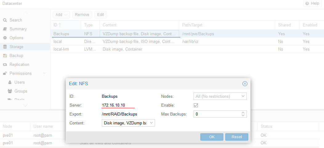

The NFS Storage on Proxmox:

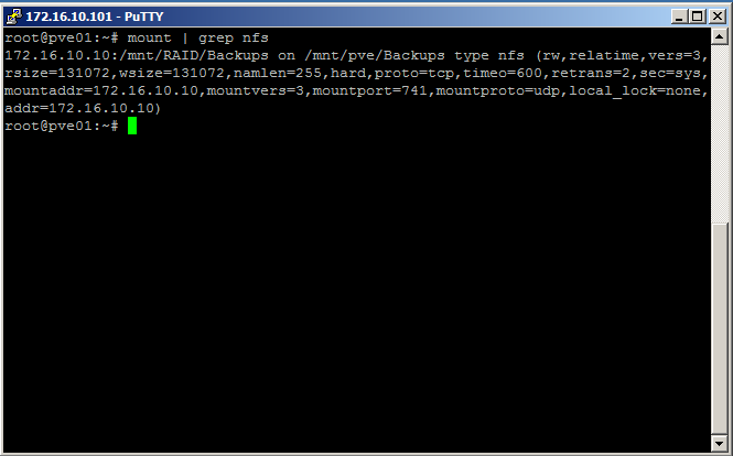

The output for
mount | grep nfs

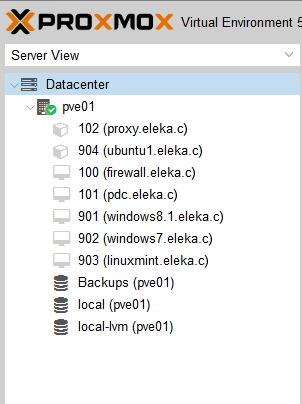

and finally, the way I find the VMs and CTs at startup (ALL DOWN), because no one does autostart since the NFS shows "NFS Shares: storage is not online (500)", even with a correct output for mount | grep nfs which indicates there is a NFS mount. This is so confusing for me.

Wasn't able to attach this one to the prior post. When I turn off the physical server and start it again, Proxmox is not able to go to the NFS share and use the virtual disks to start VMs and CTs. However mount | grep nfs shows the opposite.

The other problem you have is an architecture problem. From your Proxmox screenshots, it doesn't look like you have a second domain controller set up. I would recommend configuring either a stand-alone domain controller (Microsoft best practices), or at least a second domain controller VM to both prevent network downtime when one VM is offline, and to provide redundancy if either domain controller is corrupted. Lastly, you might want to look into running a read-only DNS server to provide DNS when your hypervisor is offline. Personally, I use BIND on my pfSense firewall to provide the capability (it syncs from my PDC), and if I have any problems with my hypervisor, and my domain conrollers are offline, it still allows me to access other network resources and the internet without having to manually tweak anything.

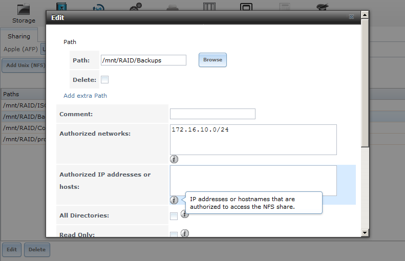

  1. What are the NFS setting on FreeNAS? Post a screenshot, and make sure to include all the advanced settings.

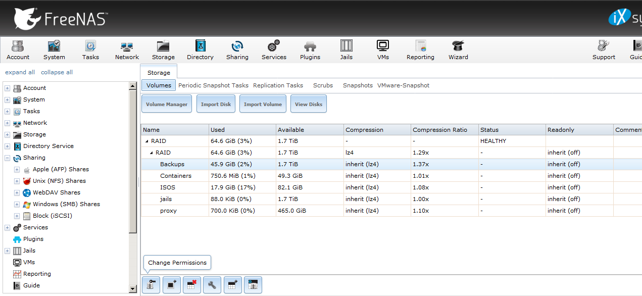

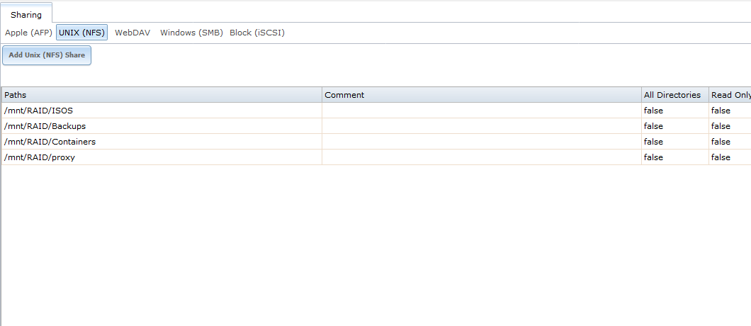

Here are some pictures of FreeNAS side
- Storage tab
- Sharing tab -> NFS shares
- A view of Backups NFS share in "Edit" mode (Advanced). I have to say there is only a defined Authorized networks but there is no data for Authorized IP addresses or hosts, maybe this could be the issue
2. What command are you using to mount the NFS share on Proxmox? Can you post the output from /etc/fstab? (make sure to sanitize any passwords).
Now the pictures for Proxmox side (if you need more pictures from FreeNAS just let me know and I would be pleased to post more)

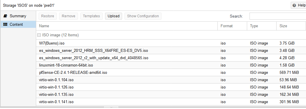

- Adding a new NFS storage on Proxmox. When I put the Server param (IP address), automatically the Export param lists all the NFS shares on FreeNAS, which means Proxmox can "see" FreeNAS and also its NFS shares without any problem. Why doesn't do the same at startup?
- When the NFS ISOS is added, Proxmox even shows the content and general data for this NFS share at FreeNAS

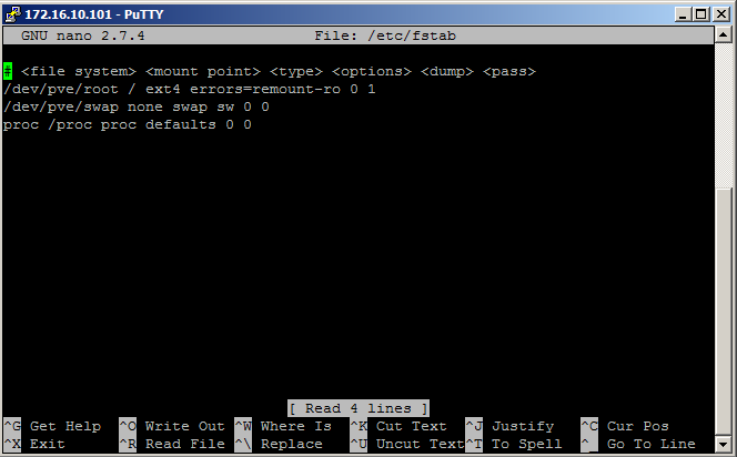

- The last thing and a curious picture is the content of /etc/fstab file. There is no entry for any NFS share such as Backups and ISOS. At the very beginning when I started to config Proxmox and FreeNAS (everything running without any issue) this file was also the same way. Maybe Proxmox keeps a different version or other data about the NFS in other location. Maybe, by not having any entry about NFS in this file is the reason Proxmox won't mount the NFS shares at startup and of course the VMs and CTs won't autostart
