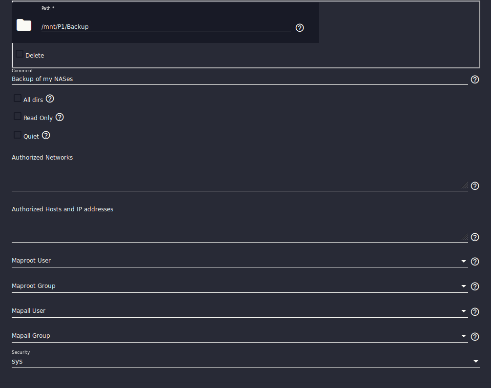

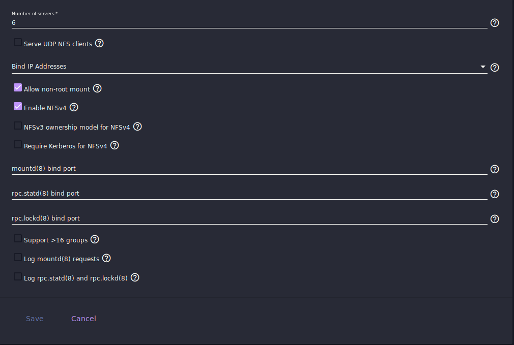

This is what I have changed:
mapall=root (Without this, users can't change owner:groups)
Enabled NFSv3 ownership model for NFSv4
