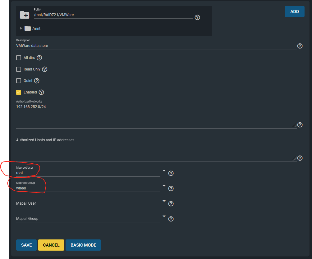

It is probably that you need to map the root user and group in the advanced NFS share properties. I have to do this to allow ESXi to mount NFS shares.

I mapped the mapall user and mapall group to the user/group that's supposed to have permissions. And it works.
