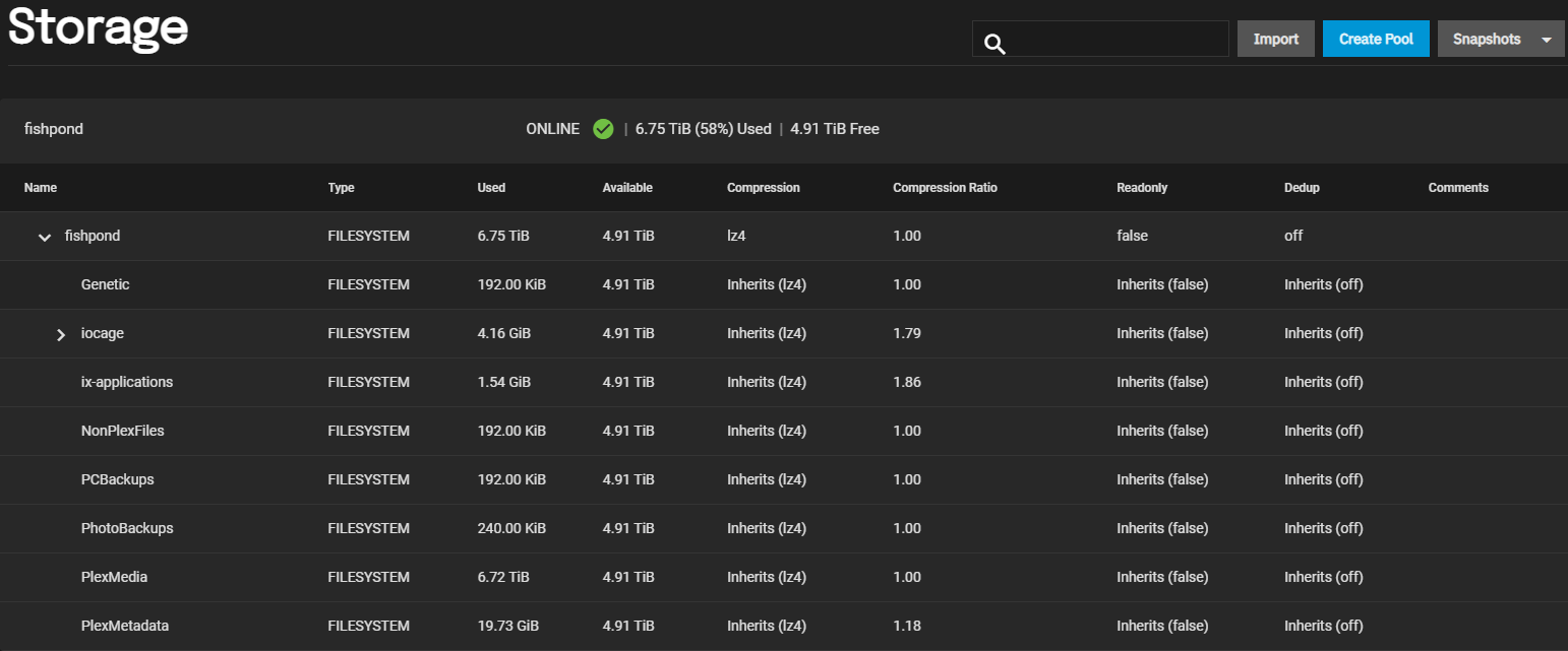

I think that maybe there is a problem with my dataset permissions:

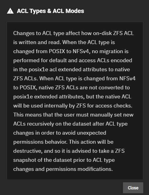

but when I went to try other settings, I got a scary message and thought I should ask on the forums before making any changes:
Back when I had TrueNAS Core, I don't remember seeing all these "(false)" and "(off)" values, so perhaps I imported the pool incorrectly?
Does anyone know what the permission settings should be for a dataset that I intend to share over NFS?
Readonly was probably always true for all your datasets unless they are replicas of other ones. Dedup should almost always be off and is so by default... what's new there is those columns are shown in the view.
You just need to set and re-apply (recursively) the ACLs (probably the ones you already had).

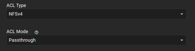

I striped the ACLs and reapplied them but that did not help immediately.
I then tried lots of combinations of settings. I got some functionality with NSFv4 enabled, but it worked much better with it disabled.
