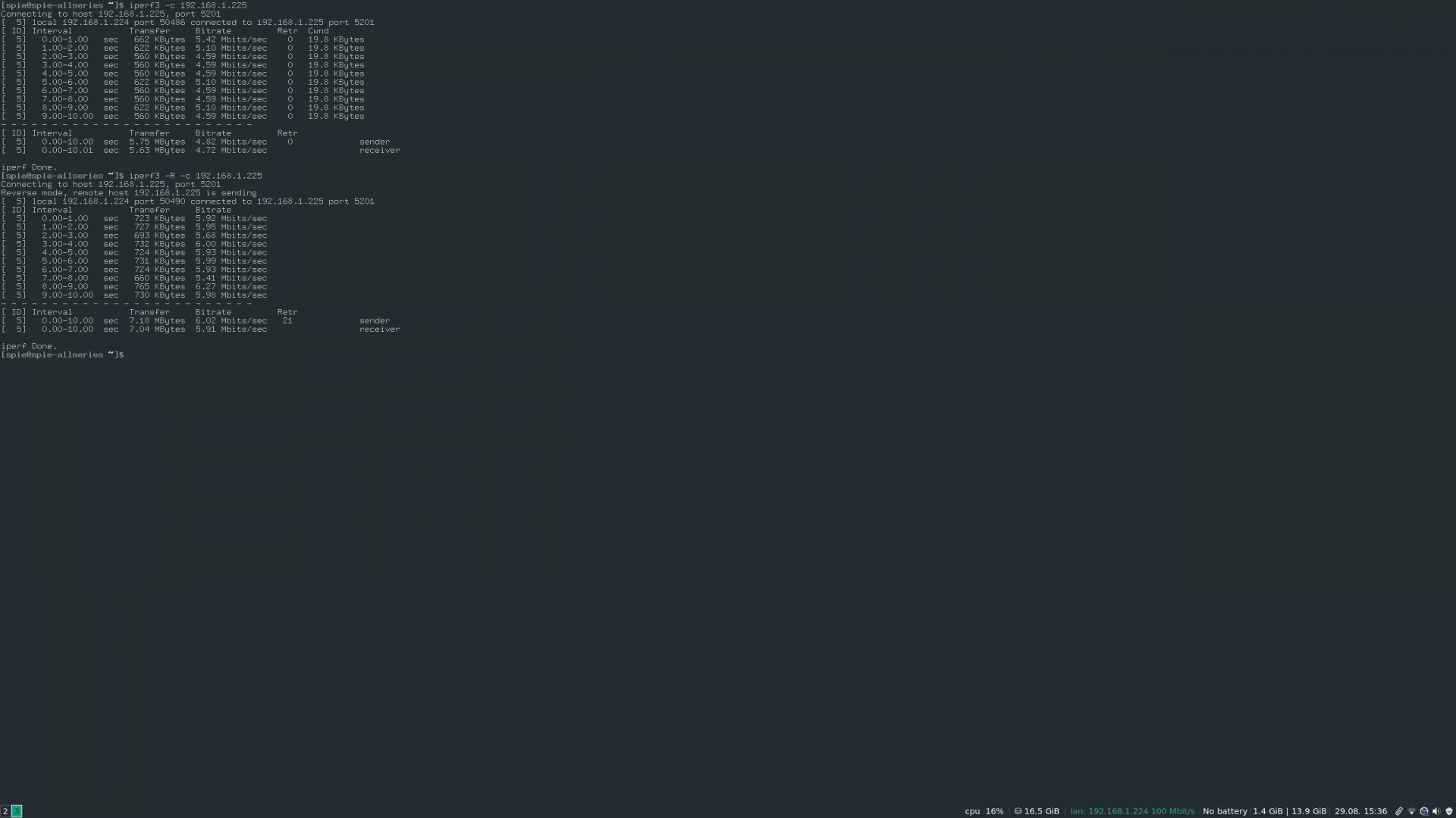

I successfully created the NFS share, mounted and accessed my files OK. I noticed that my read and write speeds while connected via ethernet to the NFS share was a terribly slow 0.5MB/s (please see attached perf network tests). It was too slow to transfer large files and too slow to watch videos that were above this bandwidth.
I am running a USB ethernet 100MBit/s adapter (ICS Advent DM9601 Fast Ethernet Adapter) from the linux computer directly into the TrueNAS computer with a Cat5 ethernet cable (I know 100MBit isn't very fast, I ordered a linux compatible Gigabit adapter, but I will not get it for a while and I suspect the problem will continue since the adapter I have has hit 100Mbit/s before via internet usage).
I can confirm I am indeed using this ethernet adapter to connect to my NFS share as my wifi adapter is disabled and I have no other network devices connected to my linux computer. Upon searching the internet and forums for anything similar, I couldn't find anything that showed promise. One suggestion was to delete the volume/dataset in TrueNAS and try creating the share with a fresh new volume. Unfortunately, this is not an option for me as I do not have spare drives or enough free space to copy my data and perform this.

My TrusNAS system specs are in my signature below as well as a debug log exported from TrueNAS dashboard. (I hope .tgz is okay, let me know if this should be re-exported to a .zip or something)
Are there any settings in TrueNAS that I should be looking into? Any ways to locate where the bottleneck might be? Or is this looking like a problem that should be posted in the manjaro forums?
