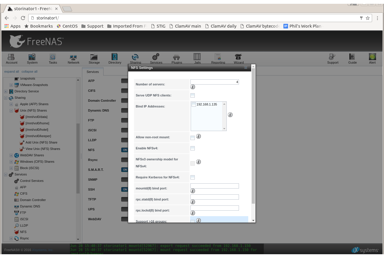

Just to be sure, you are exporting over nfsv3 and not nfsv4?
Phil Dumont
Jun 23, 2016
14
Affirmative. In the FreeNAS NFS service settings the "Enable NFSv4" checkbox is clear.
