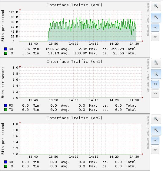

Update: I *may* have found the problem, or part of it. While I was using the Freenas server intensively for backups and other tasks, the system was slow so I decided to look at the system reports in the WebUI only to notice the speed graphs for the network cards to be rated up to 100Mbps while they should be up to 1Gbps...
The server motherboard has 3x gigabit adapters (as confirmed by Supermicro's website for the X7DBE+) and also by a pciconf -v on the freenas CLI:
em0@pci0:6:0:0: class=0x020000 card=0x109615d9 chip=0x10968086 rev=0x01 hdr=0x00
vendor = 'Intel Corporation'
device = '80003ES2LAN Gigabit Ethernet Controller (Copper)'
class = network
subclass = ethernet
em1@pci0:6:0:1: class=0x020000 card=0x109615d9 chip=0x10968086 rev=0x01 hdr=0x00
class = network
subclass = ethernet
em2@pci0:11:2:0: class=0x020000 card=0x107615d9 chip=0x10768086 rev=0x05 hdr=0x00
device = '82541GI Gigabit Ethernet Controller'
class = network
subclass = ethernet
The reports graph is attached.
Do I need a special driver or to manually activate something?? The switch being used is a ProCurve 1800-24G (J9028B) and supports LACP, Gbps and other enterprise features so this shouldnt be the problem..
I will try doing a search on google once more for more clues but if someone has an idea please share.
Thanks!

@freenas-supero, on the switch, use LED Mode Select Button and please verify speed and duplex on ports connected to your NAS and to the client machine.
Or use web interface... If you have access to the switch web interface, please check received/transmitted errors on both ports too.
No VLANs ? The traffic is not going through some router connected 100FDX ? Etc.

@solarisguy, I have checked the Procurve switch and saw no communication errors whatsoever but noticed that while all ports were configured for "auto" speed, in the status page, 3 out of 24 were reported as 100Mbps while the others were reported as 1000Mbps as they should. On the 3 ones reported as 100Mbps, 2 of them are connecting IPMI cards which I *believe* cant do Gigabit anyways (to be confirmed). The remaining 100Mbps port is the one that connects the freenas server to the network and acc. to the Supermicro site, the port should be Gigabit capable so is the switch...
Obviously I tried to manually set the port's speed to 1000Mbps in the switch's Web interface, and after a few seconds noticed that the speed in the "reports" page of freeNAS went up to 400Mbps...
So 2 questions:
1. Why is using Auto setting on the switch does not use native hardware capability? (in my case Gigabit)
2. I have plenty free ports on the switch, and another unused ports on the freenas server (the server has 4 ports, 2 onboard LAN, one IPMI card with a dedicated port and another LAN port that I believe is shareable...) Could I use something like LAGG to create redundant/additional communication channel between the switch and the freenas server? Would it help? Right now, 7 virtual machines are using the server for storage, while 3 physical clients are using it also for read/write intensive applications...
Also to answer you: No VLANs and the freenas server is directly connected to the procurve switch (so are the other machines).
@rs225, "when multiple NFS clients were communicating over a ZFS dataset" I strongly believe that this is what I am doing... On the dataset I created, I have several NFS mount points that I share with Linux VM's. I am not using freenas to store VM's.

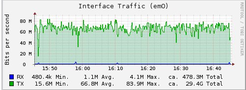

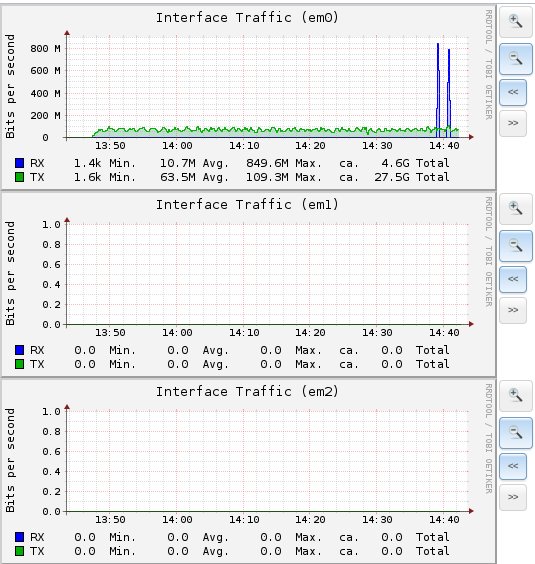

I am very sorry I have mis-identified the cables and it happened that the port that the freenas server is using on the procurve switch is set to 1000Mbps (auto).. The port I thought was 100Mbps is for the IPMI of the freenas server...
So I confirm:
-The switch port is set to "auto" and currently runs at Gbps
-The cable is working fine (and is Cat6)
-There were no errors on this port (according to the switch's logs)
-Freenas is reporting the adapter em0 as 1000bateT
em0: flags=8843<UP,BROADCAST,RUNNING,SIMPLEX,MULTICAST> metric 0 mtu 1500
options=4219b<RXCSUM,TXCSUM,VLAN_MTU,VLAN_HWTAGGING,VLAN_HWCSUM,TSO4,WOL_MAGIC,VLAN_HWTSO>
ether 00:30:48:7f:11:ba
inet 192.168.0.4 netmask 0xffffff00 broadcast 192.168.0.255
media: Ethernet autoselect (1000baseT <full-duplex>)
status: active
I did some tests (using dd on the client and netcat on the freenas server) and the results are quite interesting:
From all clients, the reported connection speed is 110MB/s (or 880Mbps) which is confirmed by the network graphs on the freenas Web interface.
So I am 99.9% confident that all networking is fine and properly setup, yet I am having terrible transfer speeds (transferring files right now at 7.5MB/s!!!) so I conclude that the ZFS dataset is the problem for the bad performances.
Network issues are IMO not to blame for the NFS lockups I reported earlier in this thread but maybe the ZFS bug reported by rs225 is to blame?
