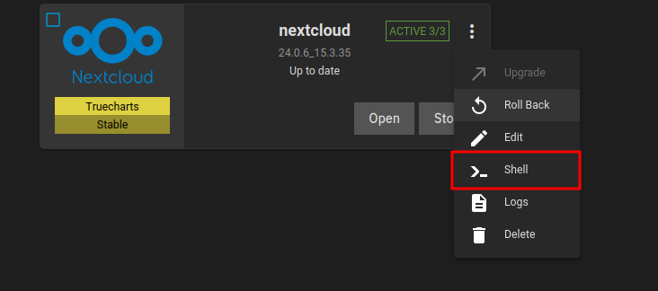

I have a truecharts nextcloud installation and I need to run the occ command inside the pod shell. The problems that I have are:
- I can't find the folder where nextcloud is installed (there's no /var/www or something like that)
- I can't login as www-data; when I run su -m www-data -c 'php occ files:scan' it asks for password
- when I open the pod shell with /bin/bash the shell user that I get is <I have no name!@nextcloud-postgresql-0> and indeed in /etc/passwd there's a "nobody" user
Heavy
Aug 12, 2021
57

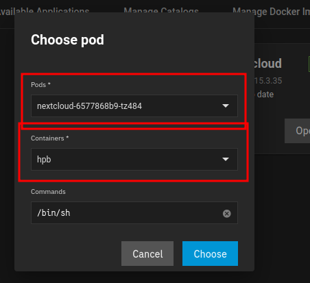

You can login as www-data with the two choices, The normal Nextcloud pod, and then the hpb container. After that your commands should run just fine.
It looks like you were trying to run the commands in the postgres shell.

Fjeld
Dec 17, 2020
3
You can also go into shell as described above. (version 27.1.3)
And enter like this: (Change the command to what you would like)
su
su -m www-data -c "php /var/www/html/occ files:scan --all"
