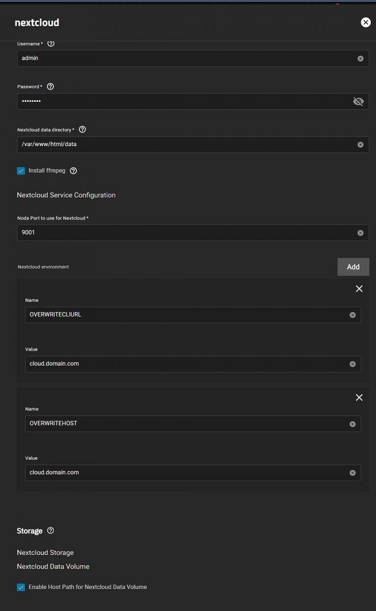

for anyone still trying to make it work with official app. I solve it by adding
Nextcloud environment variables (one of 2 showed fixed it)
instead of editing config.php. I ataching picture with my working conf.
In case if picture wont work:
Add Nextcloud enviroment in app setup or edit existing app.
Name: OVERWRITEHOST and/or OVERWRITECLIURL
Value: cloud.yourdomain.com View attachment 66052

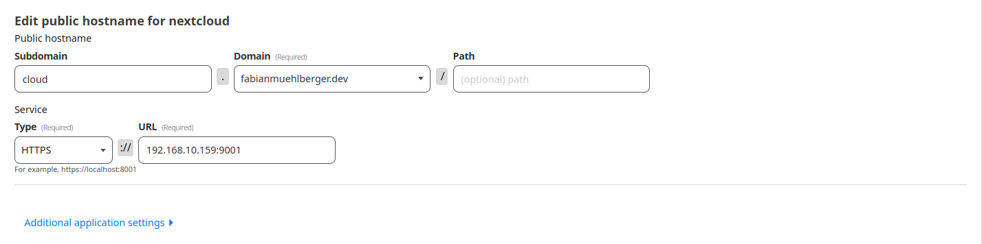

In the Cloudflare One dashboard, set a public hostname for accessing Nextcloud, this hostname, in this example it is: nextcloud.example.com

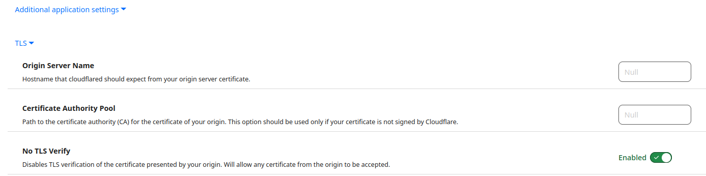

The service Type is set to HTTPS and the URL is the local TrueNAS IP + the Nextcloud container port, e.g. 192.168.1.1:9001
In: Additional application Settings > TLS > No TLS Verify = Enabled

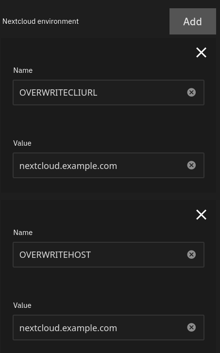

Two environment variables must be set in the Nextcloud application.
overwrite.cli.url and overwritehost
This forum post provided a solution to configuring Nextcloud to for the Cloudflare tunnel reaching the correct port.
In the Nextcloud App, the environment variables are edited as shown below, where `value` is the address.
