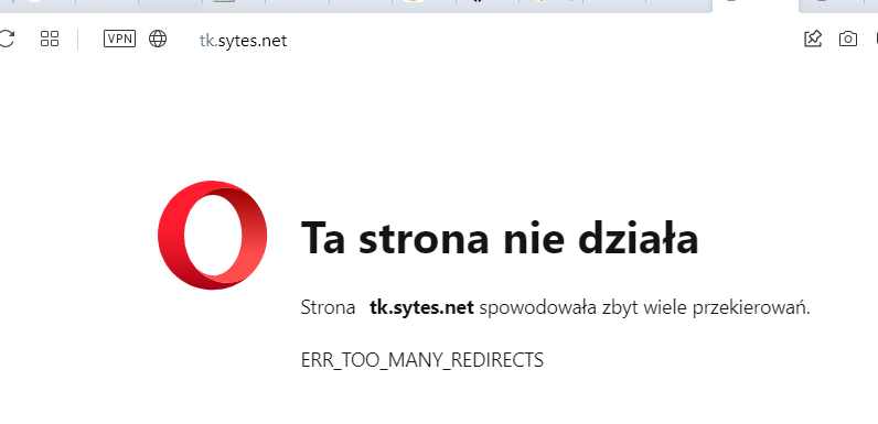

Hi there! Did you solve that issue? Mine is simillar and I do not have more ideas how to fix it.
I run TruNas 12-U8, Nextcloud 23.0.3_1
Mostly I was looking on https://www.florian-rhomberg.net/20...d-jail-using-https-and-lets-encrypt-part-two/
The same error:

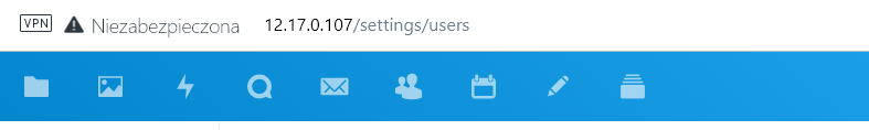

I can only acces thru local IP, but connection is not secured.
