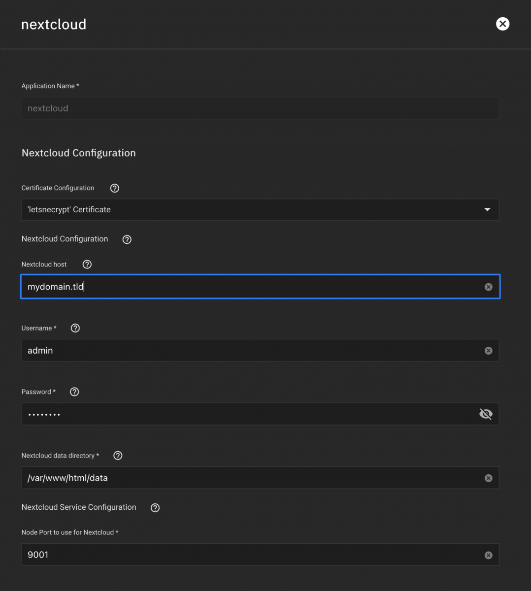

I have a TrueNAS SCALE instance installed with Nextcloud 23.0.2_1.3.13 installed through the Apps section in the TrueNAS SCALE UI. After I install Nextcloud, I am able to access the web UI through my local IP and it works well. However, When I try to access Nextcloud from my domain (let's call it mydomain.tld), it keeps trying to redirect me to my local IP. I have found other similar issues like this on these forums and Nextcloud's, but none of the solutions that worked for them worked for me.
Here is my setup:
Here is a list of things I have changed and/or tried:
Here is my setup:
- TrueNAS version: TrueNAS-SCALE-22.02.0
- Nextcloud version: Nextcloud 23.0.2_1.3.13
- DNS: Domain registered and protected with Cloudflare
- Port forwarding: Internal port 9001 -> External port 443
- Certificate: Let's Encrypt
- Nextcloud app config:

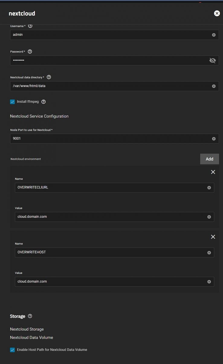

- setting the overwrite_url and overwrite_cli_url in Nextcloud's config.php to mydomain.tld

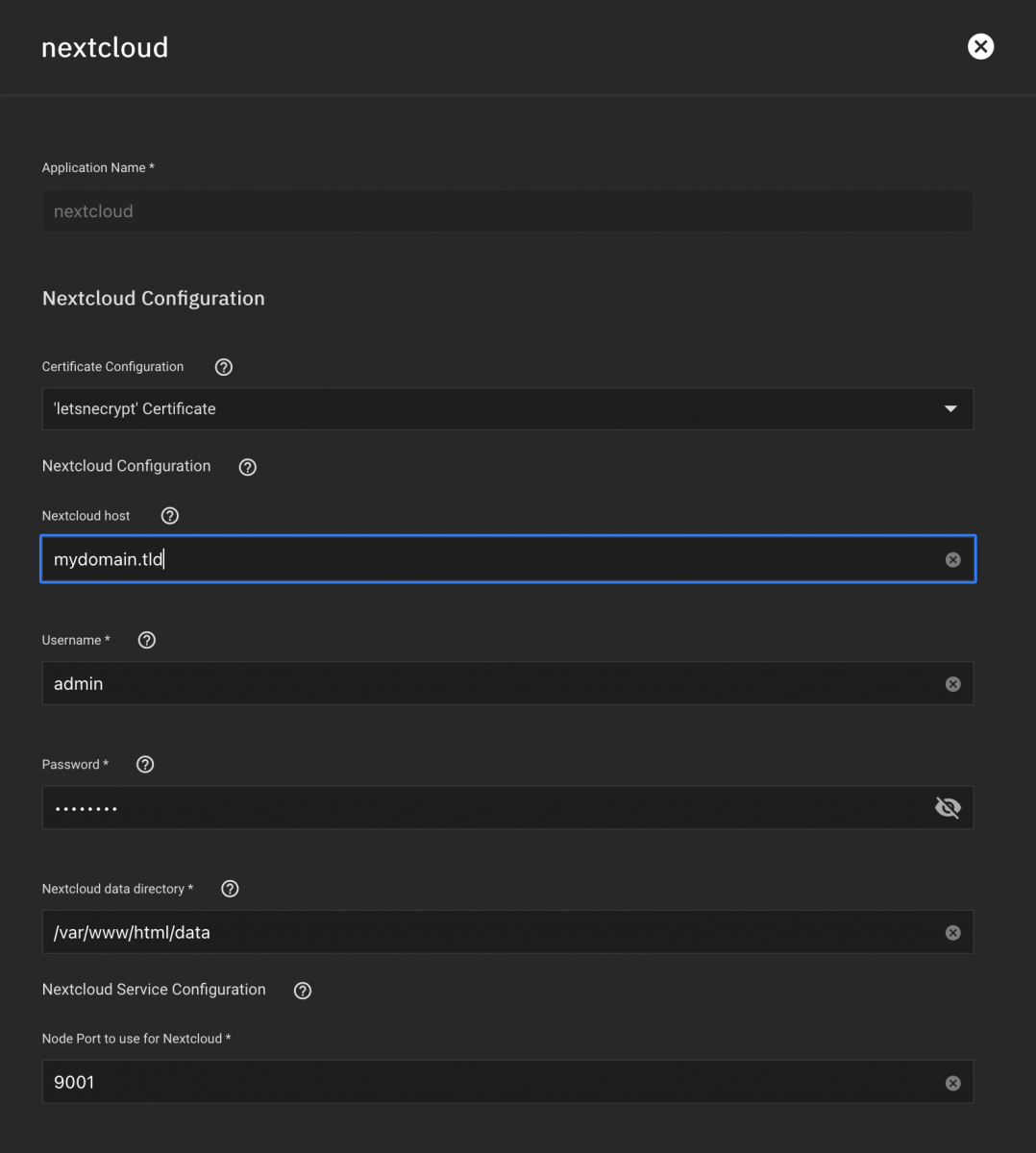

- changing the host from my local IP to mydomain.tld (this results in the domain being right, but not the port)
- Adding Cloudflare's reverse proxies to the trusted_proxies in Nextcloud config.php
- Turning off Cloudlfare proxy and setting it to dns only
- Port forwarding and testing another webserver to confirm its TrueNAS or Nextclouds fault
