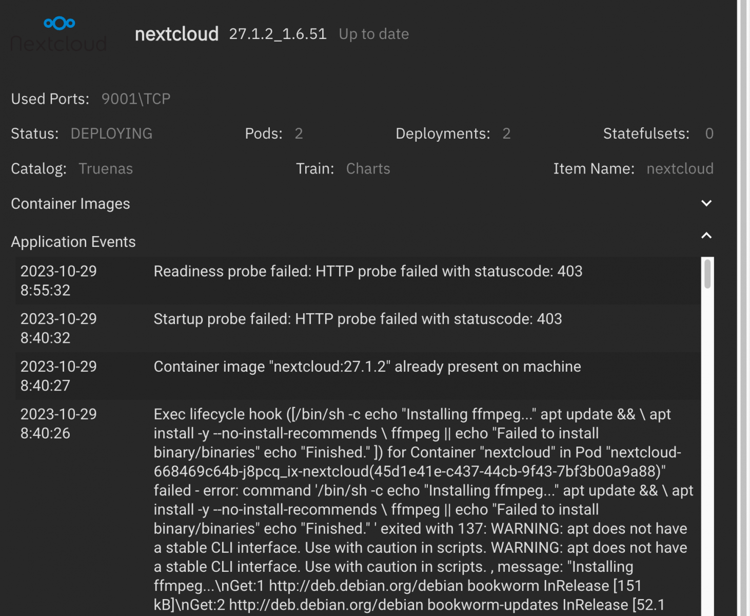

hello,maybe i have the similar problem,could you explain the detail of the solution, such as some photos
this is my problem:
Redasurc
Oct 29, 2023
I have the same thing happening on a Nextcloud instance, that was working fine before.
Tired to create a blank new installation from the ix-catalog but the problem persist.
How did you solve it? I cannot find an advanced menu anywhere in the container settings.
Nextcloud: 27.1.3_1.6.52
Truenas Scale: 22.12.3.3
