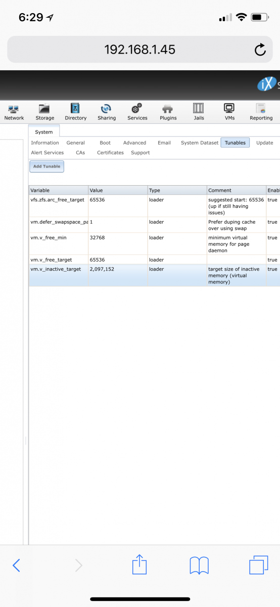

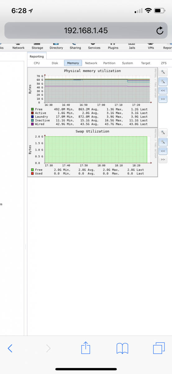

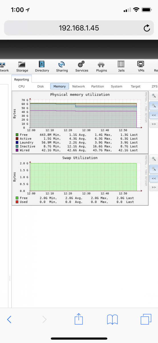

A little update:
Using the info from a Reddit page mentioned in one of the links I added a few tuneables:
vm.v_inactive_target (target size for the inactive queue)
vm.v_free_min (similar to free target, but specifies a hard limit as I understand it).
I pulled the free target back up to 65k pages and made the free min half that (since 256megs isn’t a very lofty amount for a free target all things considered) & set the inactive target initially to 10gb then lowered it to 8gb.
I haven’t had a chance to run the system through it’s paces too much (based on what I read the laundry queue gets cleaned once there is memory pressure & it has to be at least 1% the size of the inactive queue - with these updates the laundry queue has been slower to fill up).
The good news is that once the inactive queue gets to be pretty large the system seems to be cleaning it up. See the screen shots attached.
I haven’t had a chance to see what will happen once the inactive queue gets large when there is 1% of it in the laundry queue, but I will soon.
Also, generally no swap useage. Before I adjusted the inactive target tuneable from 10gb to 8gb there was a small amount of swap useage. But this time around I believe there is none.
