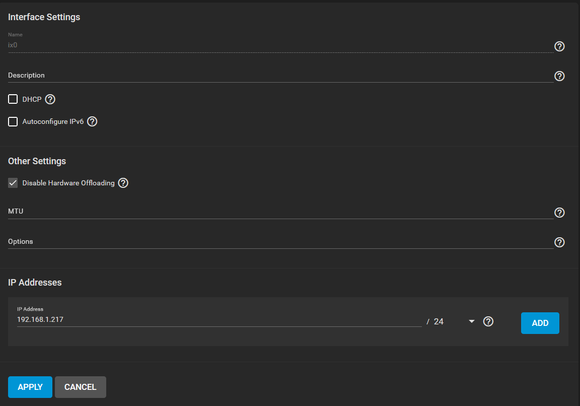

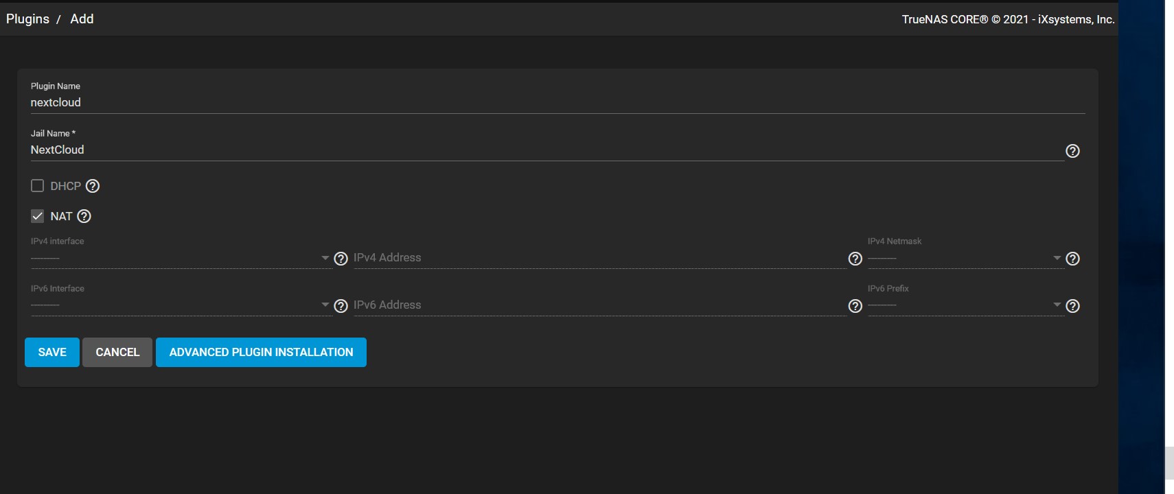

I'm trying to install Nextcloud on a TN Mini-3.0-x+ with TrueNas Core 12 -U7. The installation failed, so hoping the Community can help solve this problem. I have no other network issues with the TrueNas 12 installation, I call access my shares via my tablet on the local network. Nextcloud is the first Plugin I've attempted to install.
  • Installation failure message:
  • Network info, please also see attached screenshots:
Disable Host Offloading selected
Static IP used
NAT selected
Thank you in advance.

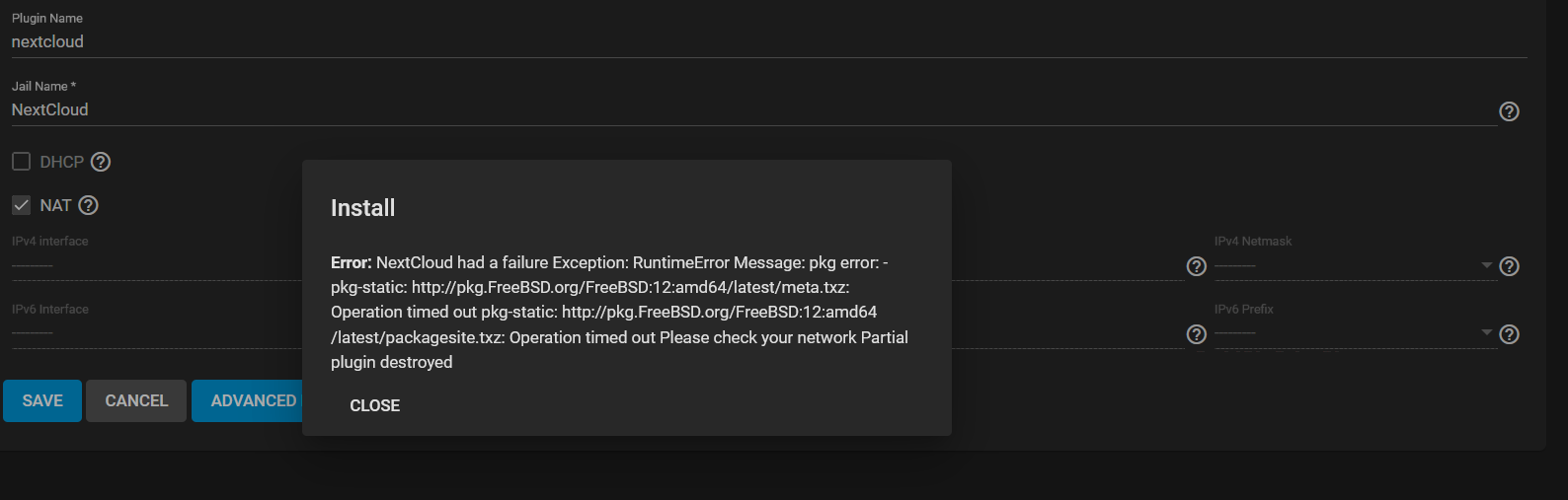

Installation Failure Message:

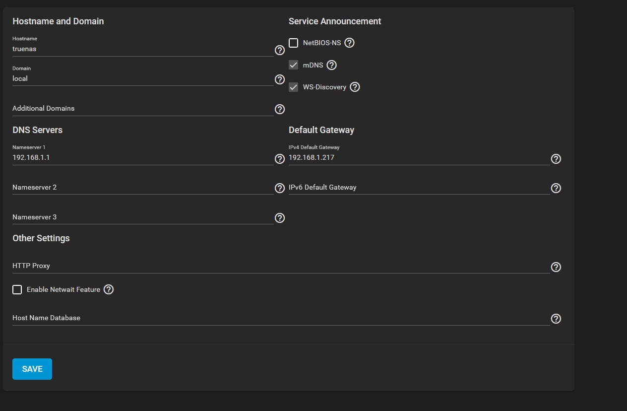

Thank you Redcoat for the reply. Please be patient, I am by no means knowledgeable on this topic, my error message appear to be related to network issues, just wondering if the problem noted in your message and the related fix are applicable to my case?
Maxter
Jan 6, 2021
7
Solved It! I had an incorrect entry for the Default Gateway. Corrected the problem and the install was successful. Thanks again for trying to help:smile:.
