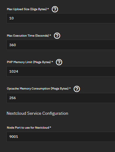

Hum, I adjusted the values as per attached, but the 512K limit is still active .... I must be doing something wrong. Can you tell me what values you are using ?
Isma
Apr 29, 2020
100
I don't know if I'll warn you, but you're missing the g to specify gigabytes

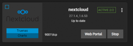

Now this wired! My setup menu is completely different and it doesn’t take letters, the units are specified between brackets.
Are we using the same version? mine is 27.1.4_1.6.53.
Are we loking at the same menu? I am looking at the menu you get after install by clicking on the three dots.
Yes, but my menu is different because I changed the official version of truenas to the truecharts version that is better and more optimized, my image is from the truecharts menu
