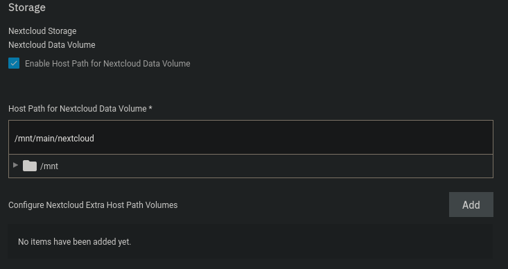

Hi, i have /mnt/main/nextcloud/users added for the Nextcloud data directory.
The Host Path for Nextcloud Data Volume is on /mnt/main/nextcloud/data.
I get this error on the nextcloud setup page:
Error
Cannot create or write into the data directory /mnt/main/nextcloud/users
bet its a permission issue. Which permissions are missing on /mnt/main/nextcloud/ users?
Which user do i have to give write rights?
Im running TrueNAS-SCALE-21.08-BETA.1.
