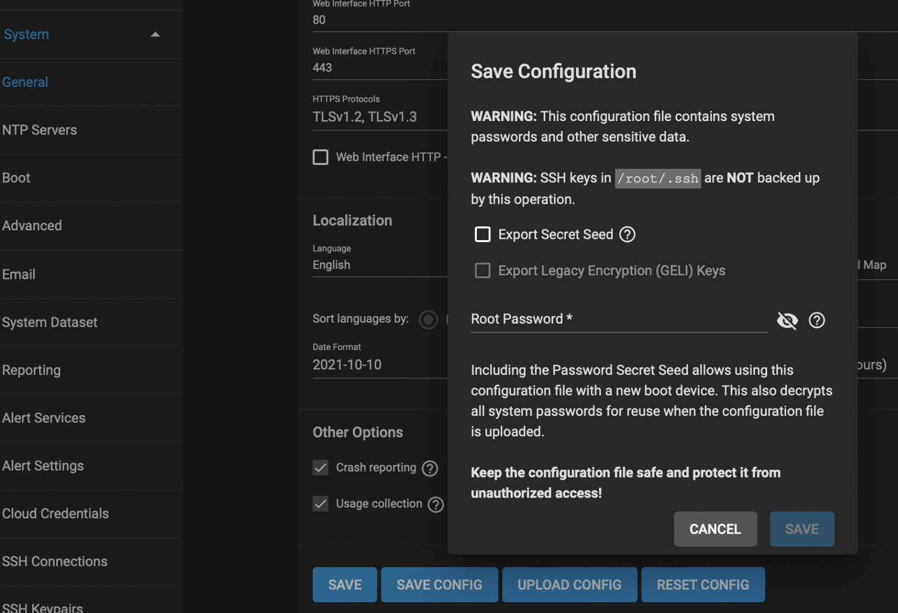

can I backup the config on a thumb drive then?
Jun 2, 2019
590
System, General, Save Config
