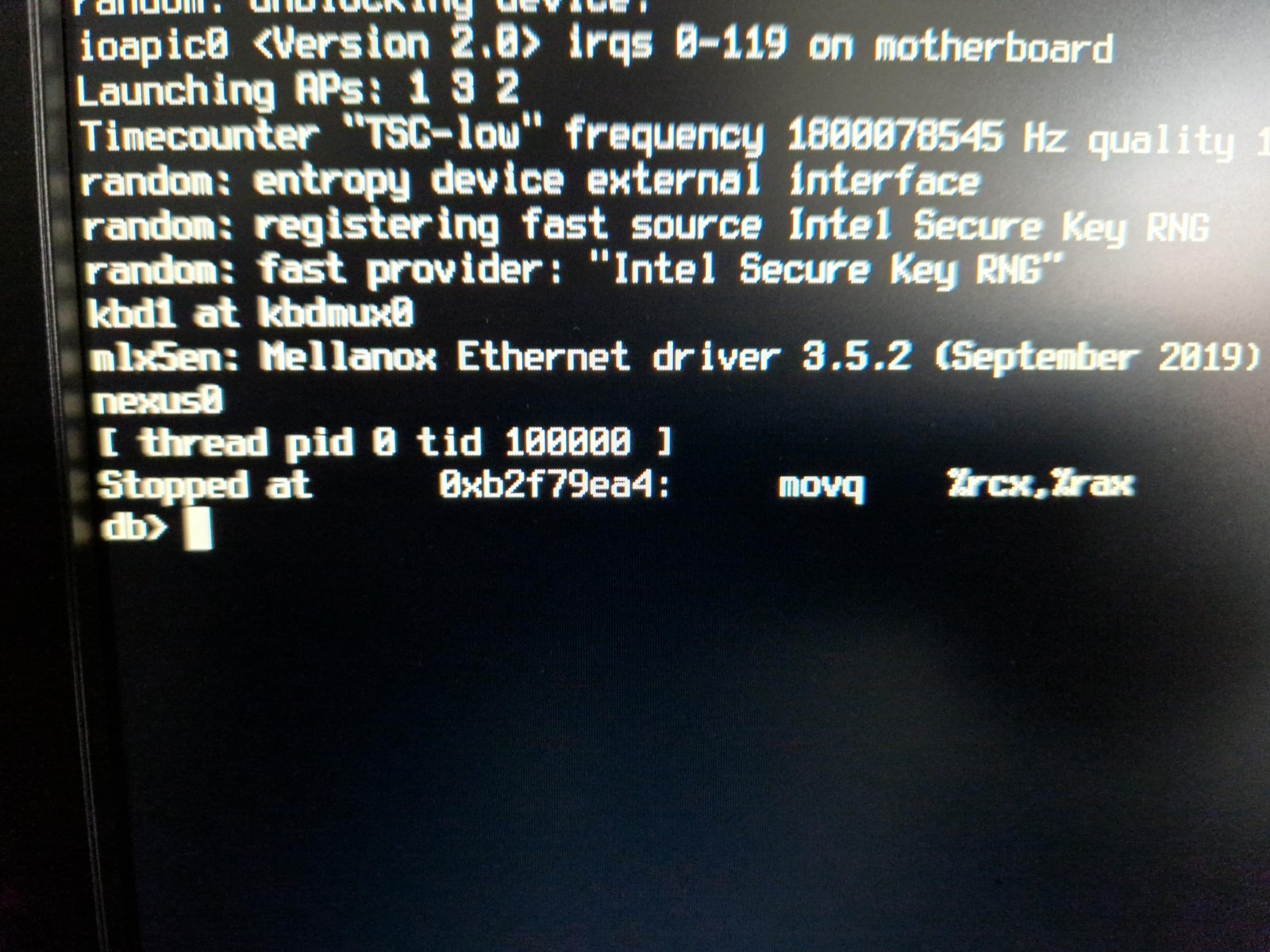

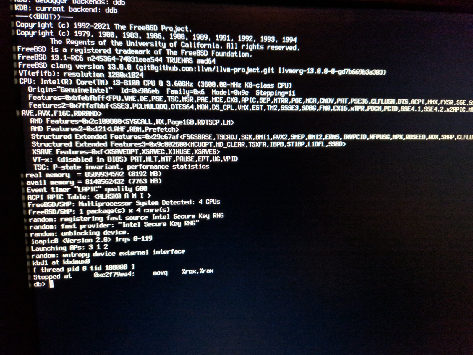

When installing Truenas Core from a USB drive on an m.2 sata drive I get notification and the installation does not proceed. Who has an idea?
Its an Intel I3 8100 system, 8 GB, 248 GB M.2 satat, Nvidia 1050. Thanks!

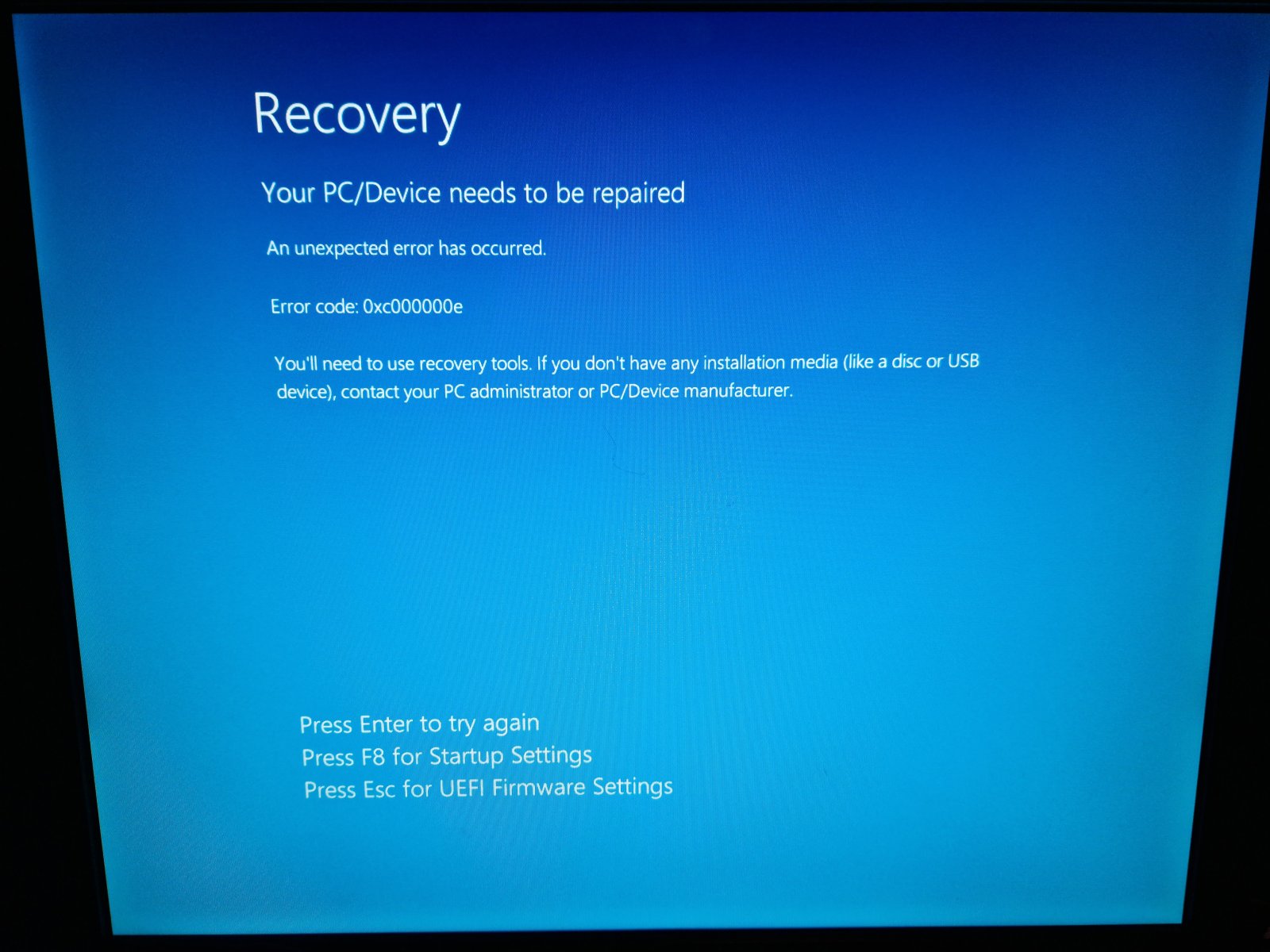

Could somebody help me out please. I really don't know what I am doing wrong. I had Truenas installed but something went wrong and it wouldn't start anymore. Now the system will start but I cannot install anymore and boot correctly. Even when I try to install windows. Over the windows error are a lot of video's made but i cannot resolve it. Maybe the errors are connect, or probably they are connected. The windows error is when trying to install windows 11: 0xc00000e.

The stoped at 0xc2f79ea4 movq %rcx,%rax is the same as before (no Mellanox any more). When trying to install WIndows 11 a got an error message too, maybe it's related?
I have no idea, please help!

5,399
This sounds like some of your memory has gone bad. Try booting with sticks systematically removed. Alternatively, try booting a Linux LiveCD that has memtest86+ available from the GRUB menu.
