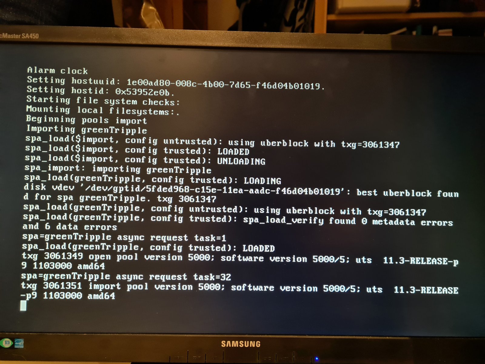

Rebooting a few days later with a GPU and display connected, I saw that the boot process halted for a long time after a "import pool version 5000 (...)":
I left it like that for more than 24 hours, before I tried reinstalling the latest FreeNAS version (FreeNAS-11.3-U5) to a fresh USB and restoring from config backup, after which the reboot halted in a similar place:

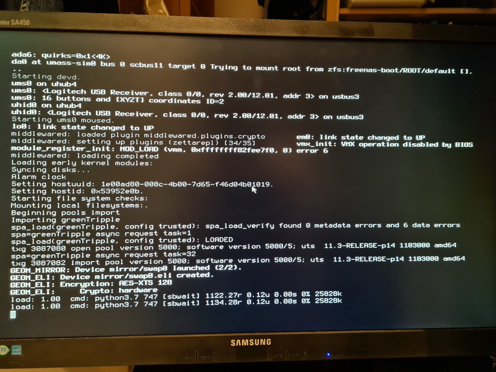

Rebooting once again (with the fresh boot on USB), I saw that it "hangs" in a similar place (this time with verbose output):
I tried being more patient, and left it like this for about 50 hours, seemingly without any changes.

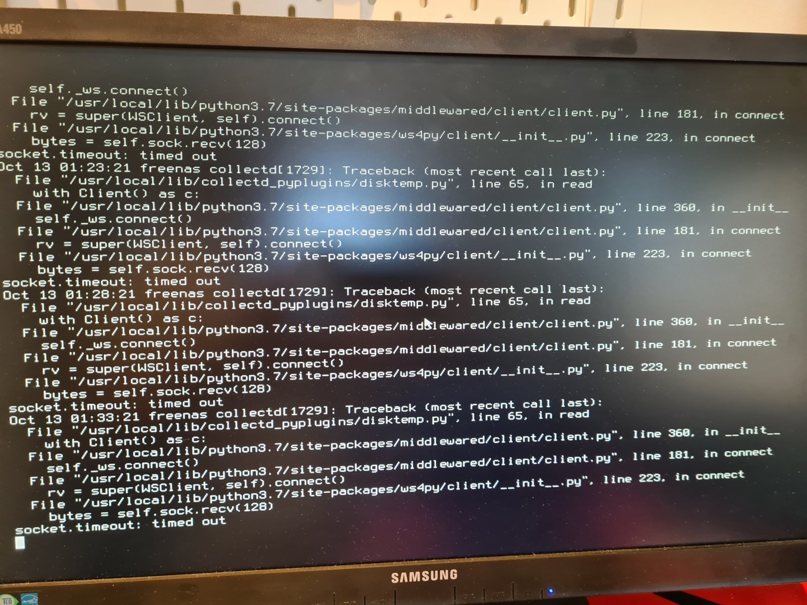

Also, whenever I Ctrl+C at the step where it always seems to halt (import pool), it later hangs at "Updating CPU Microcode":
Lastly, I re-installed fresh once again to a USB stick (this time FreeNAS-11.3-U1, the same image I originally installed on the 2x SSDs), and extracted smartctl reports (attached) for all 3 disks in the seemingly problematic pool. I then again tried to import the pool through the GUI, which again made the GUI stop working like the previous time. This time I was already at the shell locally on the server, and I also noticed I was able to ssh into the server. Running htop I see that a python middlewared worker is using 100 % of a CPU core, and the local shell console keeps displaying a python exception (a few minutes apart or so):

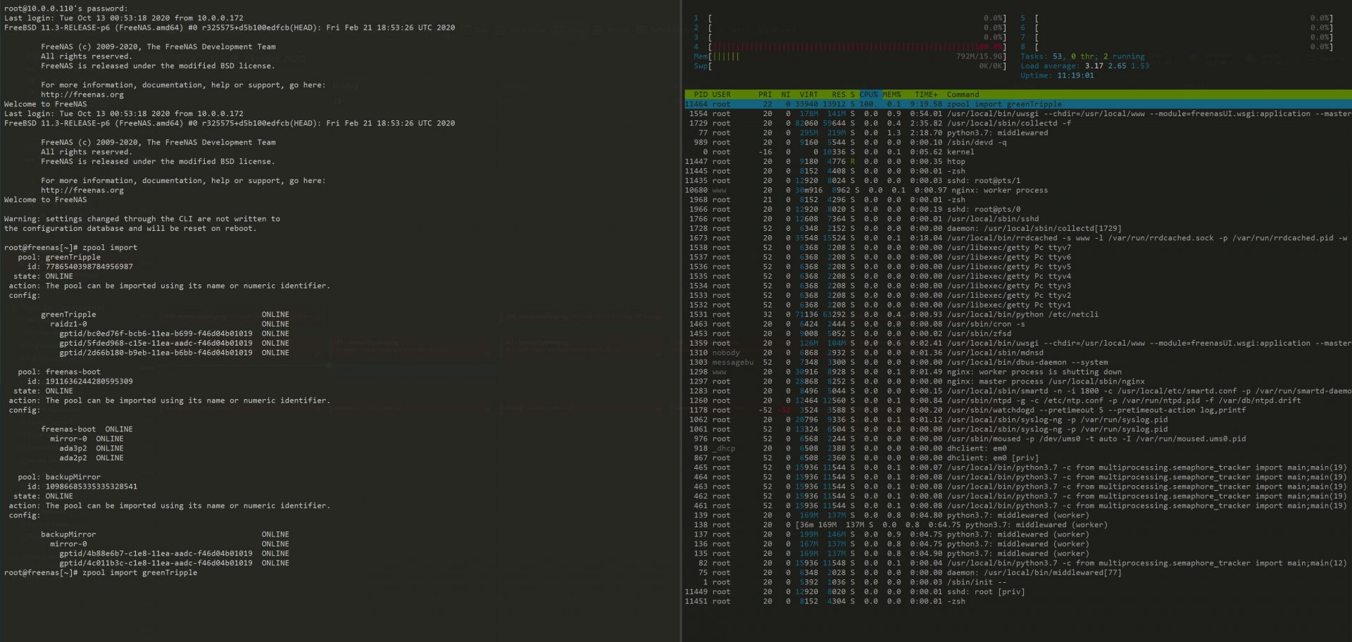

root@freenas[~]# zpool import
   pool: greenTripple
  state: ONLINE
 action: The pool can be imported using its name or numeric identifier.
 config:
        greenTripple                                    ONLINE
          raidz1-0                                      ONLINE
            gptid/bc0ed76f-bcb6-11ea-b699-f46d04b01019  ONLINE
            gptid/5fded968-c15e-11ea-aadc-f46d04b01019  ONLINE
            gptid/2d66b180-b9eb-11ea-b6bb-f46d04b01019  ONLINE
   pool: freenas-boot
  state: ONLINE
 config:
        freenas-boot  ONLINE
          mirror-0  ONLINE
            ada3p2  ONLINE
            ada2p2  ONLINE
   pool: backupMirror
  state: ONLINE
 config:
        backupMirror                                    ONLINE
          mirror-0                                      ONLINE
            gptid/4b88e6b7-c1e8-11ea-aadc-f46d04b01019  ONLINE
            gptid/4c011b3c-c1e8-11ea-aadc-f46d04b01019  ONLINE

Ok. Is it normal that it does not give any output at first, and takes a long time?
Edit: This also caused GUI to become unavailable again with the "Connecting to FreeNAS... (...)" message as before, and I'm seeing the same exceptions in the locally connected display:

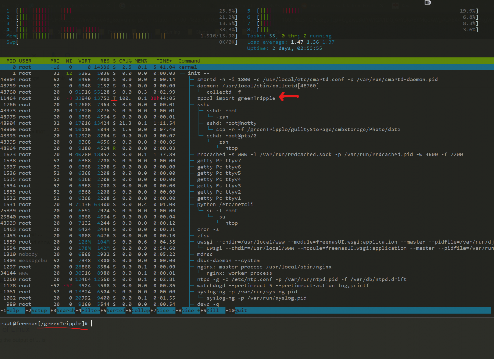

Even though the zpool import greenTripple hung when run (and I had to kill the terminal), I noticed the pool is actually available when I ssh into the server, even though the import process is still running with 100 % CPU on one core:
I am therefore able to make a backup of the important data in the pool so that I can try the zpool import commands with special flags that you suggested, sretalla (have not got my hands on another storage large enough to image the 3x 4 TB drives in the pool yet)
I have tried to kill the zpool import greenTripple process, but it seems un-killable, which from what I understand means that its blocked in a system call, but shouldn't the STATE then be D and not T (terminated/stopped)?

I did try this, but it does not seem to change anything.
From the docs (https://www.freebsd.org/cgi/man.cgi?zpool(8)), I guess thats because "This option is ignored if the pool is importable".
And, like I indicated in my previous post, it actually seems like the import is successful, as it becomes available in the filesystem.
However it seems like the pool is then instantly busy for some reason, and the "zpool import" command never finishes (and sits at 100 % CPU, unkillable).
I tried exporting the pool afterwards, but only get an error that it cannot umount my shinobi jail:
root@freenas[~]# zpool export greenTripple
cannot unmount '/greenTripple/iocage/jails/guiltyShinobi': Device busy
I then tried a forced export, which also seems to fail:
root@freenas[/]# zpool export greenTripple
cannot export 'greenTripple': pool is busy
but after a hard reboot (since the import command is un-killable), the system came back up without the pool imported, so the forced export must have succeeded in some respect.
EDIT: Correction, pool was still imported, but not showing in GUI or filesystem and not available for import. However, running zpool export greenTripple another time now succeeded.
I then tried importing the pool as read-only, which seems to work fine without any issues; the server is still operational and I am able to access the data. Then exporting the pool and attempting another import (without readonly) I get the same issue where the command hangs at 100 % CPU forever, although the import does seem to succeed, as running commands in another shell I see the pool as imported and I'm still able to access the files.
Attempting to export it again returns an error stating that it cant unmount my shinobi jail.
Running zpool iostat shows me that no reads/writes actually occur on the pool...
Any Ideas what to try next?
