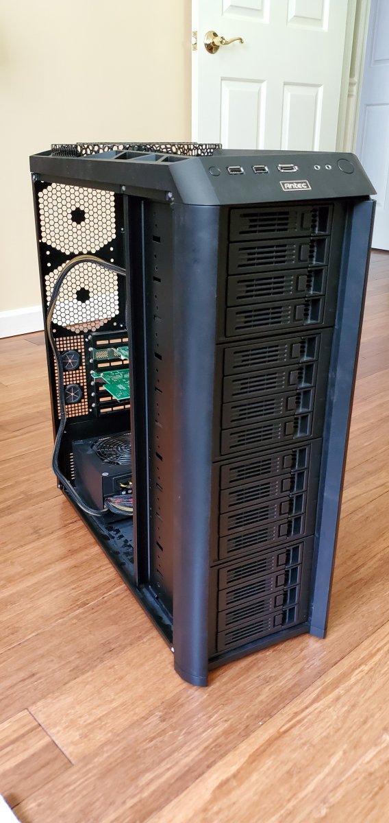

There's a bunch of great cases out there but I've always had my eye on the Antec 1200. I like the desktop form factor rather than rack mount and the drive count is prefect. Don't mind the dust, it's a vintage case.

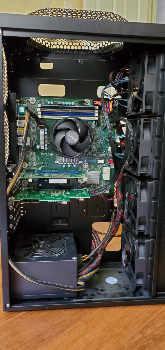

MOBO: ASRock Rack MB X470D4U
CPU: Ryzen 5 2600
HDD: 4x 3TB WD Red
HDD: 4X 4TB HGST
HDD OS: 64GB M.2
RAM: 32GB ECC
PSU: 750 Watt Antec (Came with the case but will be upgraded once things are back in stock)
Case: Antec 1200 V2
Dell H310
IBM ServerRaid 16 port
4x Rosewill 3 x 5.25-Inch to 4 x 3.5-Inch Hot-swap bays

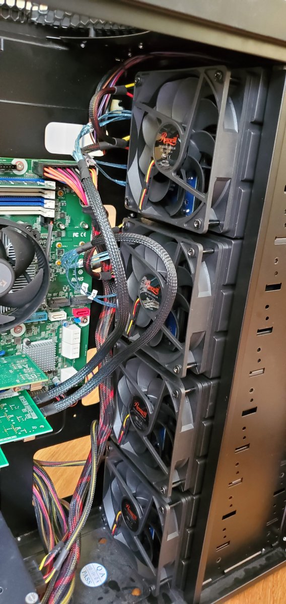

I'm waiting on some Noctua fans and some more sas breakout cables to come in then it should be ready to start moving data. This will mostly be for movie / tv streaming with the Emby server plugin. Maybe a few VMs.
One thing I didn't realize is that the stock AMD cooler interferes with the memory slots. I'll have to find a new cooler at some point.

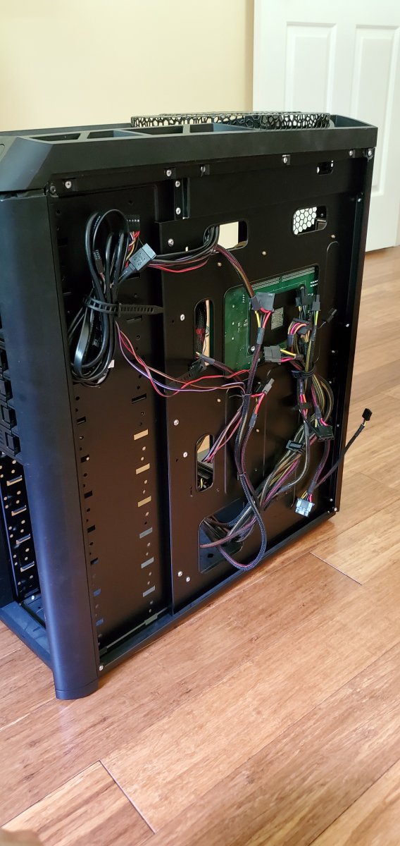

Anyways here are some pics. Cable are a hot mess for now from the older PSU cables.

When you get up and running, be sure to keep an eye on your temperatures. If you are not using all the disk bays, I would consider mounting one of the fans on the back as an exhaust fan. It will help air movement through the case.

Yeah so I'm replacing all the current fans on the hot swap bays and adding 2 rear exhaust fans.

If you are going to run 8 drives only, you may not need so many fans. I would be very surprised if you needed more than one fan behind each cage that you are using, and one exhaust fan. Don't forget, these cases were originally designed for gaming, including support for high end CPU's and graphics cards that are major heat generators. You don't have those concerns.

It will be 8 drives for now but probably not more then 12 total for mass storage. I plan to use the bottom hot swap bay for some short term storage / cache for Emby and other stuff on VMs.
