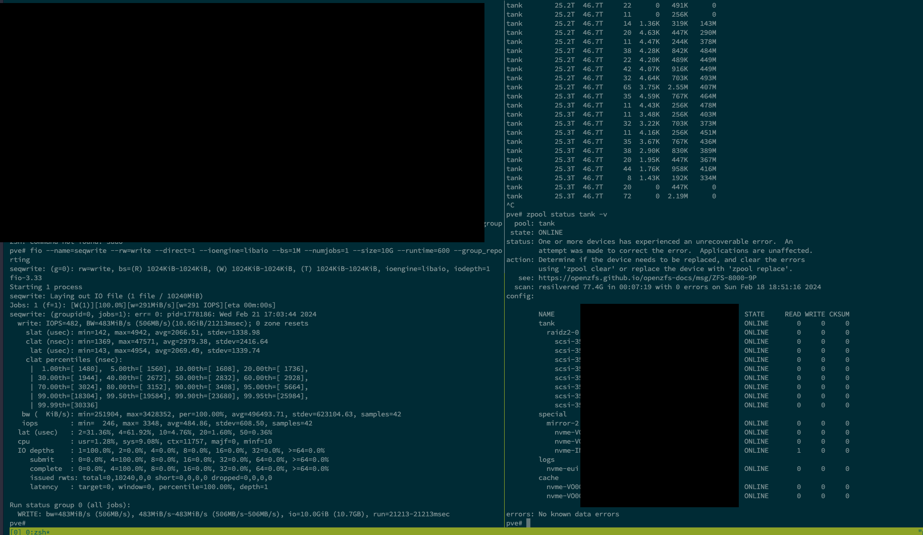

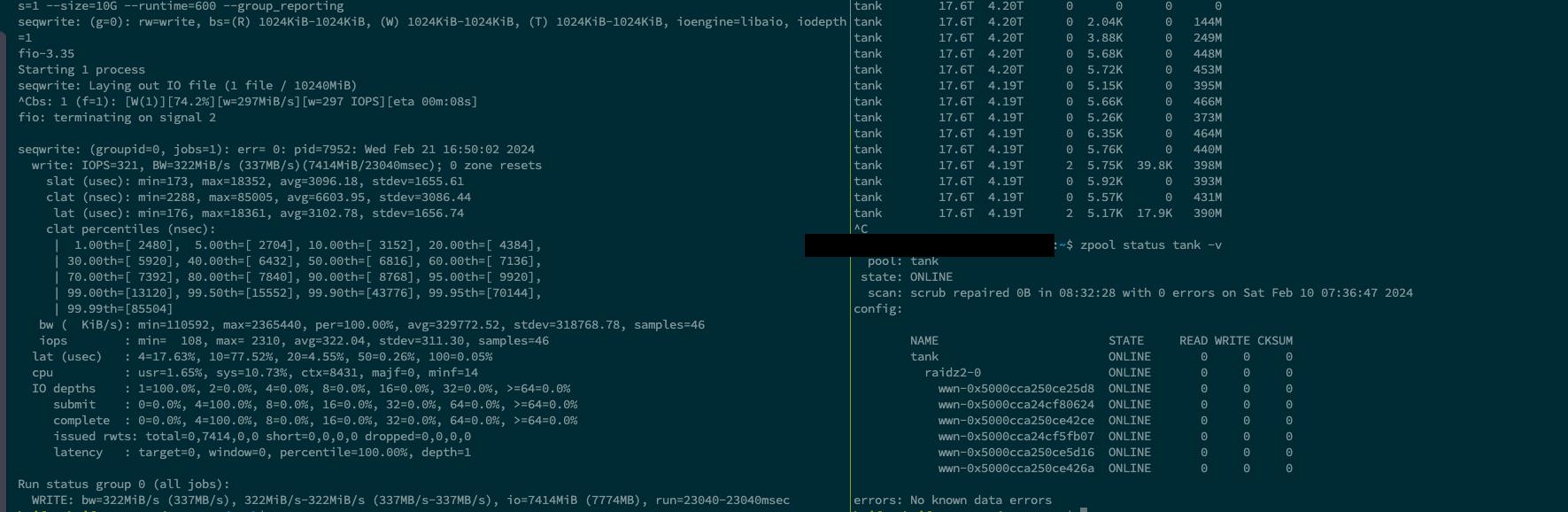

I had a old pool with 6x 4TB sata drives with no frills, fio benchmark below
good write performance at around 400MBps old drives from 2016.
I got a new pool with 8x 10TB SAS drives which I get the worse from, its more uneven! in seq write that is.
This is not expected, with drives that can read/write at 200MBps compared to 100 of the old sata drives I expeced to get more seq performance outof this new setup.
I need to ideas how to tweak or understand this behaviour better.

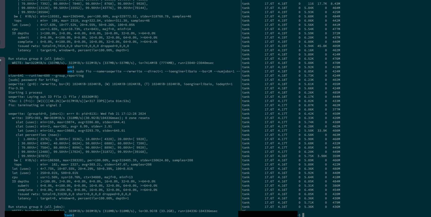

Its silly but look at each drive performing much better with to old sata sompared to the 10TB sas drives!
ondjultomte
Aug 10, 2015
117
the new this which are on datasheet twice as fast are in reality twice as slow! ...

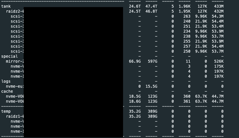

I notice a key difference is you added SLOG and L2ARC (in addition to the special VDEV).
Perhaps remove the SLOG and L2ARC first and retry your tests.
I could try that, but that should defenetly only just improve things if eg synced writes.

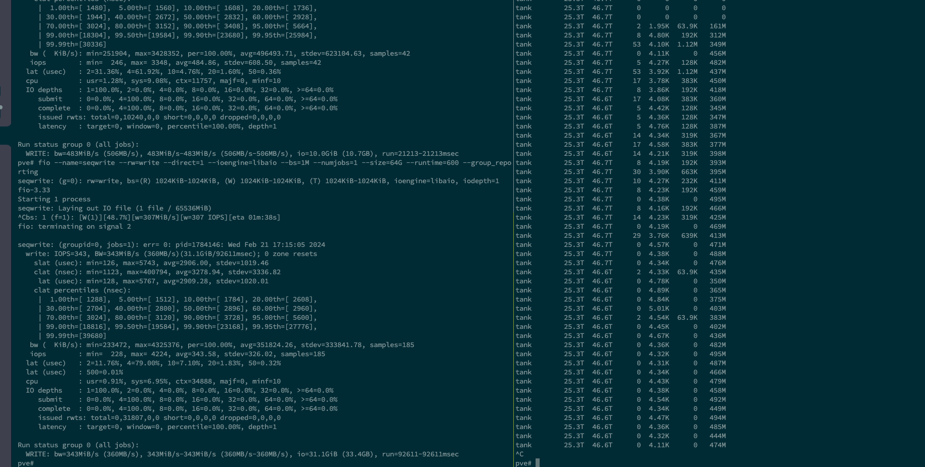

wow, adding the slog and l2arc made the old pool faster ! :)
600MBps
