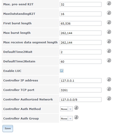

So , I have turned on LUC and used the following configuration:
you can see the attached screen shot
anyway , I am also writing the information which you will see inside the screen shot:
Controller IP address: 127.0.0.1
Controller TCP port: 3261
Controller Authorized Network: 127.0.0.0/8
Controller Auth Method: None
Controller Auth Group: None
The problem is that still I encounter the same issue , and when I am creating new extent in the level of FreeNAS I still do not see it in the ESXi level until I don't restart the iSCSI service in the level of FreeNAS.
