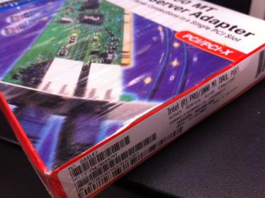

Where'd you pick up the Intel card? The market is occasionally flooded with cheap knock-offs that work poorly (or not-at-all), sometimes so blatantly as to be some other "Realtek"-class chipset. You might want to double-check that the driver you found to work with the card is an Intel driver.

I have a 9301 CT NIC, chipset 82574L, and it works quite well. Mine does use em0 so I assume it's a real one.
Working doesn't prove it's a "real one", sadly. Nor does buying from an authorized retailer. We usually buy cards through the Intel evaluation program, but that takes time. Back around 2006 we purchased some PWLA8492MT dual port cards from NewEgg for an on-site emergency in Virginia, one arrived DOA, one seemed to work but would go into fits of rage every few days. Back in the shop, we eventually got around to looking at it, and discovered that the cards were pretty good fakes, right down to the packaging, but were identifiable because the word "dual" on the serial number label on the side of the box was spelled "daul"...
The box and packaging would not otherwise have been suspicious, the box itself appears identical to other Intel cards, and the board was very similar too, except the soldering was of slightly lower quality. We ran into some other service providers who had also been hit with fakes, similar symptoms. Possibly even Intel manufacturing rejects or something like that.
Fakes happen. Just be cautious. ;-)
So far no good. I got this card from Newegg, and it's using the 'em' driver. It also has a counterfeit prevention mechanism from a company that I'd never heard of, "Yottamark". It's a holographic sticker with a QR code and a long number. Going to Yottamark's website and entering the number, or scanning the QR code, results in a page declaring that my device is valid, and it gives me the correct MAC ID for the card. This is sort of nice, but I've never heard of Yottamark, and I can't see how this would protect against 1M counterfeit cards all with the same holographic sticker and MAC ID.
