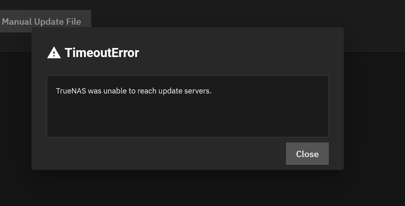

I have been using an old HP Proliant ML30 to set up a NAS with TrueNAS Scale (TrueNAS-SCALE-22.02.2.1) which has been working great, however I recently noticed when I tried to do an update (ERROR: "TrueNAS was unable to reach update servers.") that while it is accessible through the network it isn't connected to the internet.

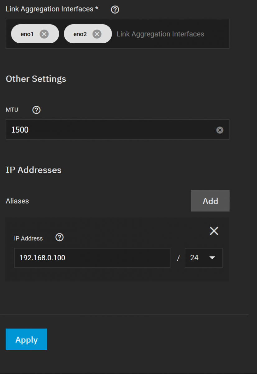

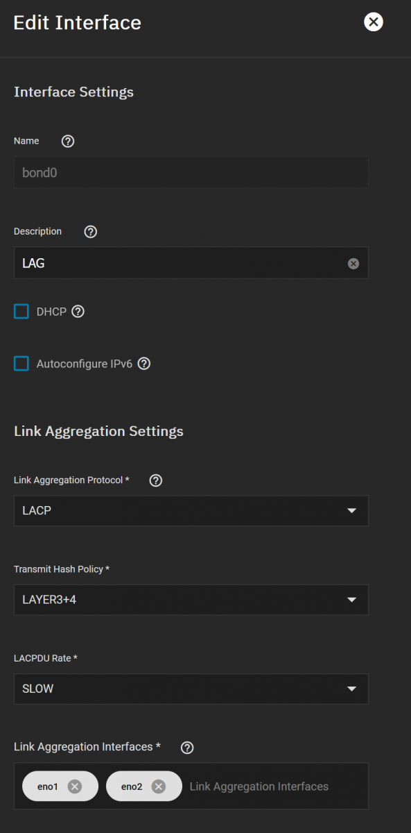

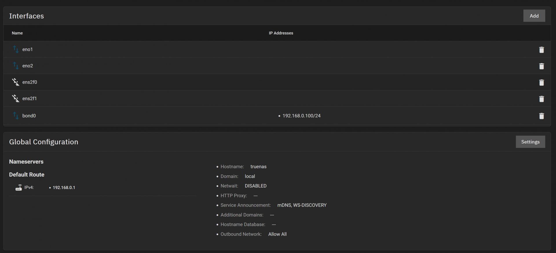

I have double checked the settings on the routers, switch and NAS and I haven't been able to fix the issue, but perhaps I have set up the NAS setting wrong, I have provided a screen grab for reference below. I use a static IP which I have set on the NAS and reserved in the router to the switch aggregate link.

Start by getting rid of that complexity and use a single NIC. I suspect you're not benefitting from it anyway.
In my understanding it is a wrong conclusion from this error description that there is no internet connection. This is a very specific error and there are multiple reasons why it could occur despite a working internet connection.
The first test would be to run something like ping www.truenas.com from the command line and see what happens.

So as you suggested I removed the link aggregation and went back to a single cat cable into the nas, I had trouble removing the bond in the web interface as it didn't pass the test of the new network settings, so I did the changes on the interface directly from the nas by connecting a monitor and keyboard, removed the bond and set up a new connection with dhcp.
I was then able to send test alert emails but couldn't connect to the truenas servers and was had between 50 - 100 % packet loss pinging google (8.8.8.8). After a second reboot it connected to the truenas servers and I was able to apply an update to bluefin (TrueNAS-SCALE-22.12.0). Everything appears to be working now with no packet loss.

I have attached a screen grab of the error for reference.
