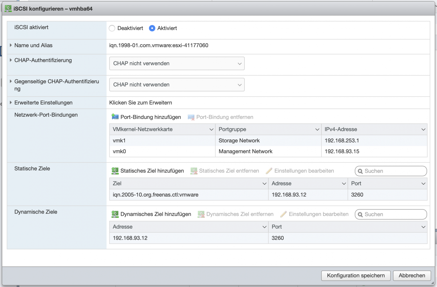

I went ahead and just create a ZVOL and shared it via iSCSI to try out things. I can redo that any time should I need to change the size or the blocksize.
But while ESXi seems to see the target I don't see the drive itself and I cannot create a new datastore for that reason.
Any hints? I set up iSCSI sharing without any authentication - that runs at the office in a separate storage LAN with manual ctl.conf without problems. The config FreeNAS creates is slightly different, though.
I'll post a screenshot from ESXi 7.0 and the ctl.conf for starters. If you are inclined to help, of course ask for whatever additional info you need.

Hey @Patrick M. Hausen,
You configured authentication on your iSCSI. Here, I never tried that. The network links are physically separate and peer-to-peer. Also, to configure or access these links, one needs to be already root in the ESXi. As such, authentication does not really help. You can try to disable that authentication and see if it helps.

I deleted the configuration and created a new one with the TrueNAS wizard - now I can detect and format the LUN. Great.
I think I will provision 70-80% of the pool to the single ZVOL and not do snapshots. Then use GhettoVCB to backup the VMs to an NFS share on my main storage NAS.

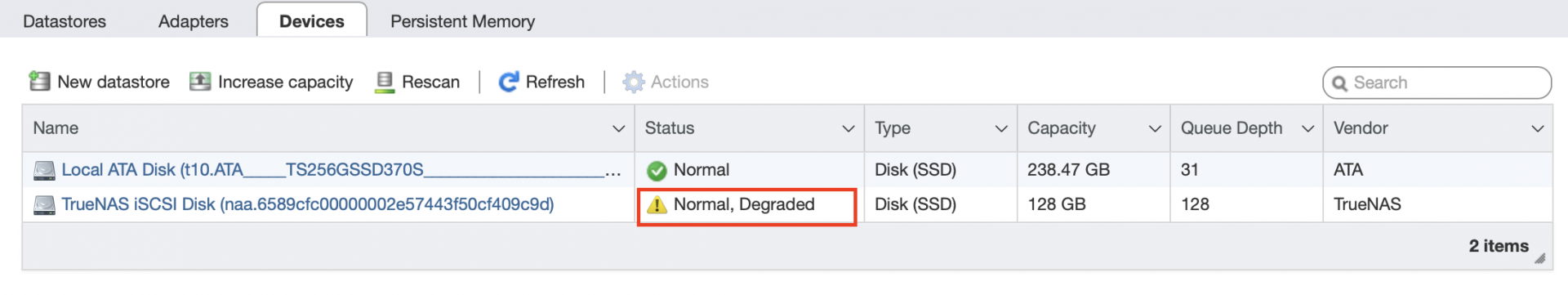

One open question - any idea what that means? See screenshot, please.
Thanks!
Patrick

Hi again,
Never had this on my side... Maybe a network problem like one of X network links being down ? Also, because you are 7.0, maybe something new in the UI a do not have in 6.7 u3....
Patrick M. Hausen
Nov 25, 2013
7,776
According to Google if there is only a single path to an iSCSI unit it is shown as "degraded".
Currently setting up a second vSwitch and network ...

Da! datastore2 now workink.
