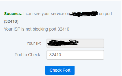

I built both a new IOCAGE jail and an old cage to see if there was any difference, but I can't find any. Both versions come up internally just fine, I attach the media folders and do all of the internal configurations I need, but when I try to make the server available remotely it will not connect. I have set port translation on my router to multiple different ports from 32400 up. I checked using canyouseeme.org and it looks like the port is available:

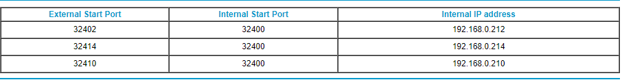

Here are the settings from my router. 214 is available remotely the other 2 aren't:
Is there a tunable or setting on 11.1-U2 I need to tweak?

I checked the port translation rules on the router again, and I am certain they match up. The iocage Plex is at 192.168.0.214, the external port is 32414 and the internal port is 32400. I can ping outside and I even know DNS is translating correctly from the server. Canyouseeme.org verifies that port 32414 is open.
