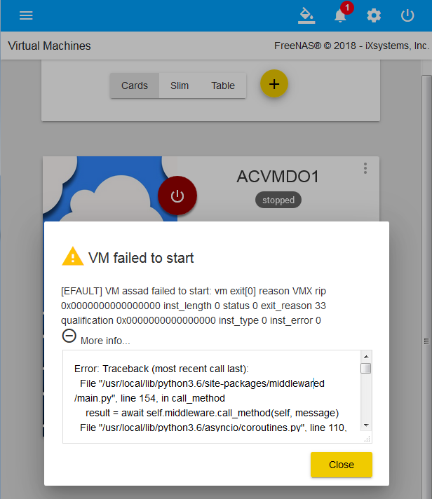

On a new FreeNAS install on I would like to test setting up a Docker virtual machine.
Expectation: A running RancherOS virtual machine.
Result: Error message "VM failed to start"
[EFAULT] VM assad failed to start: vm exit[0] reason VMX rip 0x0000000000000000 inst_length 0 status 0 exit_reason 33 qualification 0x0000000000000000 inst_type 0 inst_error 0
see extended log shown in window at https://pastebin.com/cYhtXvzh
on the console it prints
tap0: Ethernet address: 00:bd:e3:xx:xx:xx
brdige0: can't disable some capabilities on em0: 0x1
Aug 16 06:59:29 freenas dhclient[5876]: tap0: not found
Aug 16 06:59:29 freenas dhclient[5876]: exiting.
Steps to reproduce (I repeated this three times):
Install FreeNAS
Set up pool (tried names tank0 and tank)
Set up Docker Host
Keep default settings, except setting raw file location on newly created pool
Click "Start VM"
System: FreeNAS-11.2-BETA2
HP Z200 Workstation (keep in mind this is a test setup to evaluate FreeNAS, production could get new hardware)
Intel(R) Xeon(R) CPU X3450 @ 2.67GHz (8 cores)
16GB RAM
Intel VT-x enabled
FreeNAS installed on internal hd
Pool set up on two 500 GB harddrives

Which FreeNAS version did you try? What system (processor, RAM, motherboard) are you running it on?
Could you provide a debug file? System->Advanced->SAVE DEBUG
For me there was no solution yet.
