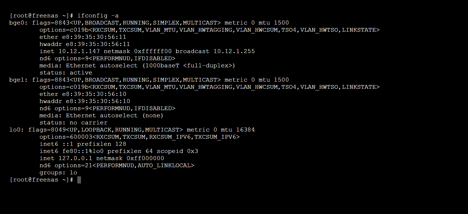

I am using Z800 Workstation with two GB ports on mother board (both are working fine as bge0 & bge1).

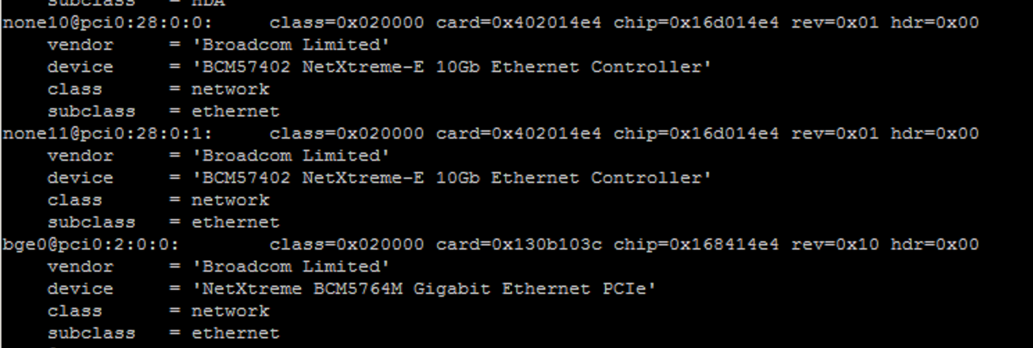

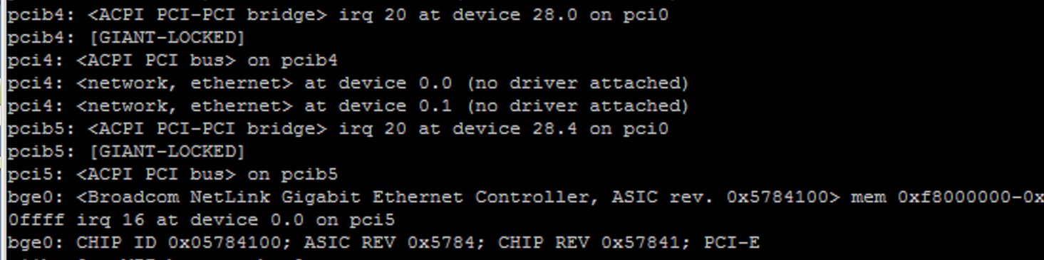

The new NIC card (2 ports) is ‘BCM57402’ NetXtreme-E 10Gb does not appear in ifconfig -a command. It is listed in pciconf -lv output correctly, but displayed in dmesg command as None (no driver attached).
