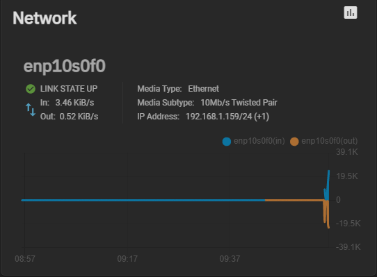

hello, i got the nics working, both of the mobo's nics are 1gb, but for some reason when i load truenas, they only operate at 10mbps?? is this some sort of thing to do with truenas?

Is jumper JPL1 set correctly - see page 2-4 in the manual? Pins 1-2 to enable the onboard LAN ports.

What class of network cable are you using and to what are your NICs connected?
i use CAT5e, i am using nic 0, i know its not the cat5e cables fault because when i plug a nic into pcie port it runs at the full 1gb.

Are you on TrueNAS Core or Scale?

i was on core, and had the issue and now i moved to scale and i still have the issue
