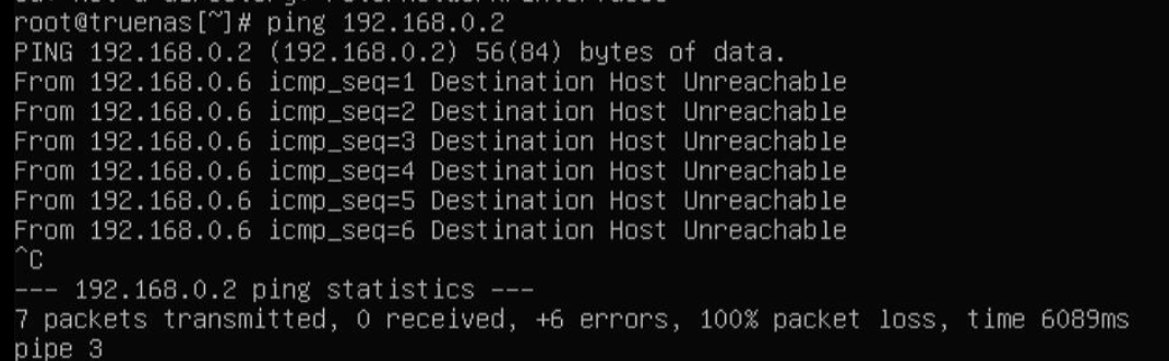

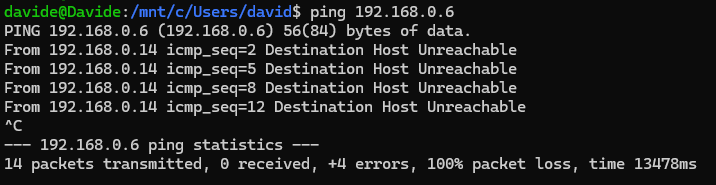

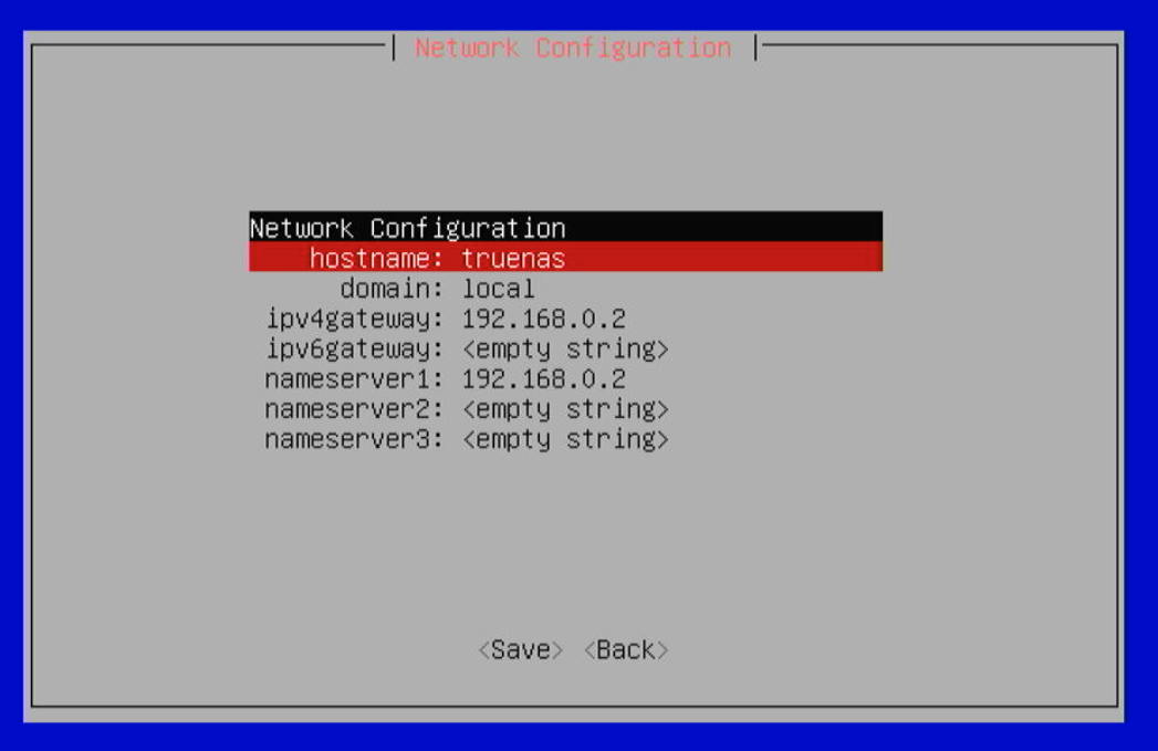

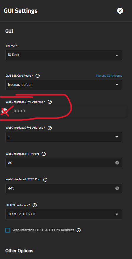

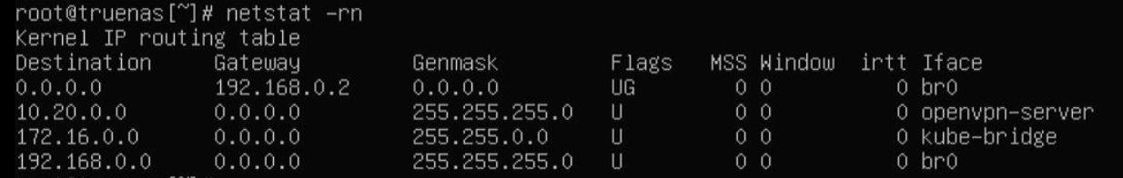

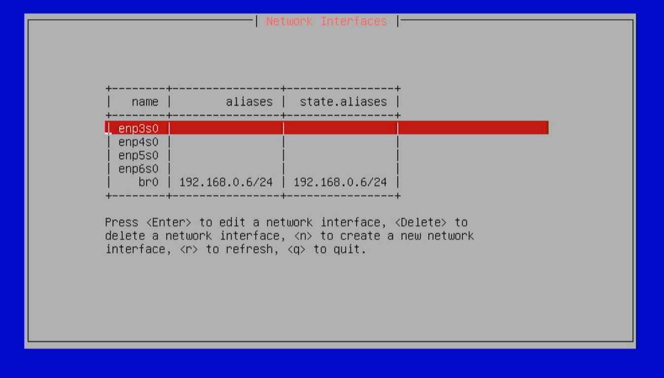

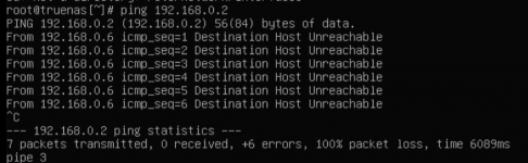

after i made a copy of truenas boot disk from one ssd to another with Gparted live usb, on reboot i can no longer access the nas and vice versa the nas does not connect to the network, directly it shows me the ip address of the UI but i can't reach it, if i try to ping the NAS it is not reachable vice versa in a direct way if i ping from truenas to the gateway it tells me the host is not reachable. Before the reboot I had unset on the checkbox of the ip 0.0.0.0 to access the GUI as I report in the screen but I don't think it is due to that... what can I do to restore the network? I don't want to restore to the default settings as I had so many configurations same thing for apps. Help!
192.168.0.2 is a Gateway

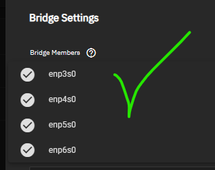

I solved the problem, with the default configuration the network was working again, basically when I uploaded the configuration file the correct ethernet port was not in the bridge (now I included all ports in the bridge for safety being the others unused).
