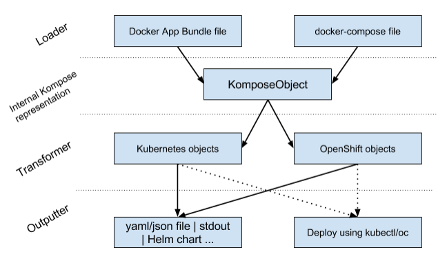

Docker Compose is the preferred tool for a Docker environment
Helm Charts are the preferred tool for Kubernetes. - they are more powerful and generally a super set of the Compose yaml file capabilities.
There is a tool called Kompose that converts Docker-compose files to Helm charts: Check it out at https://kompose.io/

Thanks, I had a quick look at kompose. At first glance, it didn't convert my mounts (e.g. from /mnt/foo on the host into the container), but I may have missed something.

I think he is trying to do what I did and local mounts that contain data that are mapped into the container don't seem to get translated properly by the kompose tool. I had a plex container that I tried converting that had 6 or 7 local mounts mapped into the container. When I look at the output of
"kompose convert"
I end up with a bunch of files like:
plex-deployment.yaml
plex-claim0-persistentvolumeclaim.yaml
plex-claim1-persistentvolumeclaim.yaml
plex-claim2-persistentvolumeclaim.yaml
but none of them actually have any of the original /mnt/Movies, /mnt/TV, etc in them and the volumes section of plex-deployment.yaml has references to those files, but again, no actual pointers to the real locations to be mapped in.

I guess we have to manually go in and add those mount points back in? Or maybe there's an additional command line argument to pass to kompose convert that we're missing?
