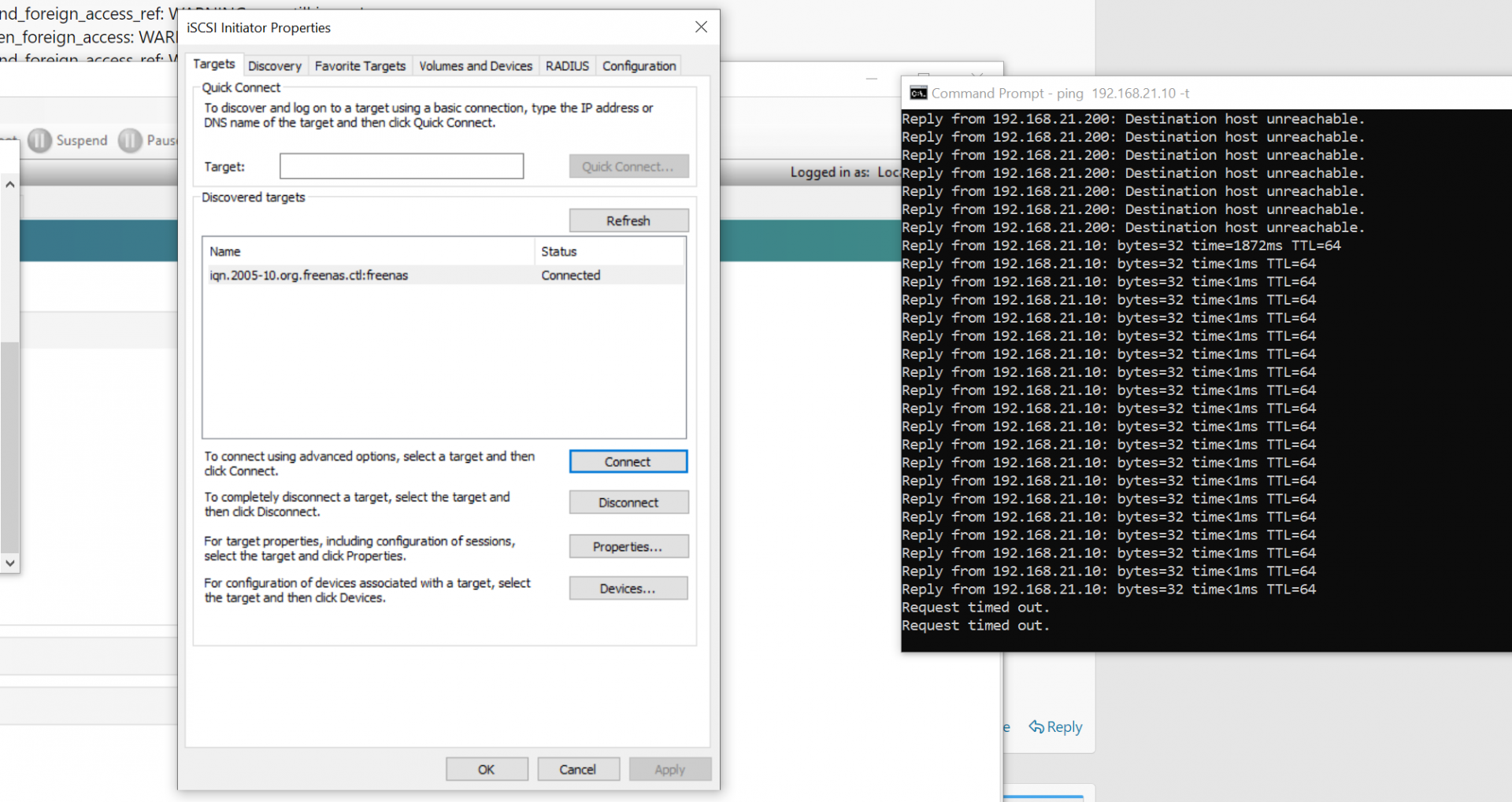

The screenshot just shows my windows machine pinging Truenas. The connection comes up as soon as I unplug and plug in the VIF, and then it goes down again as soon as I try to connect to the iSCSI drive in windows. Windows shows it is connected to the iSCSI, but it doesnt work at all.
