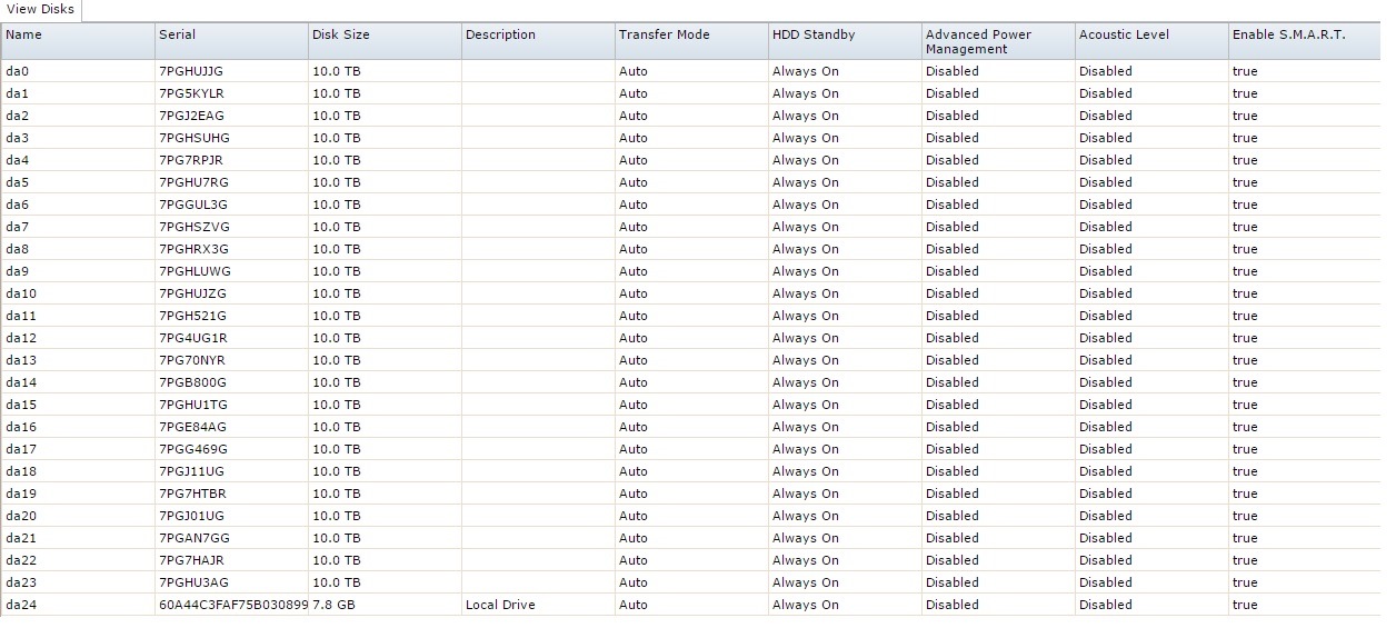

JohnFLi
Sep 26, 2016
139
yup currently only using 18 drives (3 vDevs of 6)
