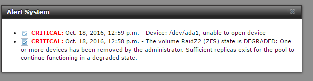

Im some what new to FreeNAS and its been fine for like a year but I just logged into the FreeNAS webpage today and it was flashing red and it shows:
How do I fix it? I didn't touch anything.

Well. Ada1 looks to be toast.
If it is toast, you replace it following the instructions in the manual.
Luckily you used RaidZ2, so your data is safe. (for the moment)

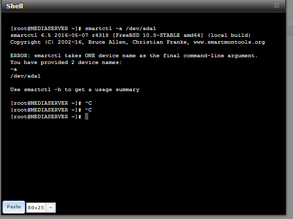

I tried the smart test i get the error:

can you do
zpool list -v
and copy the results back in a CODE tag?

1st of all: Please replace that drive!
Yeap, the command is correct. Do what @Stux said above to ensure you have the right info, but: replace that HD ASAP!
Edit: The warning says: Removed by the administrator?!

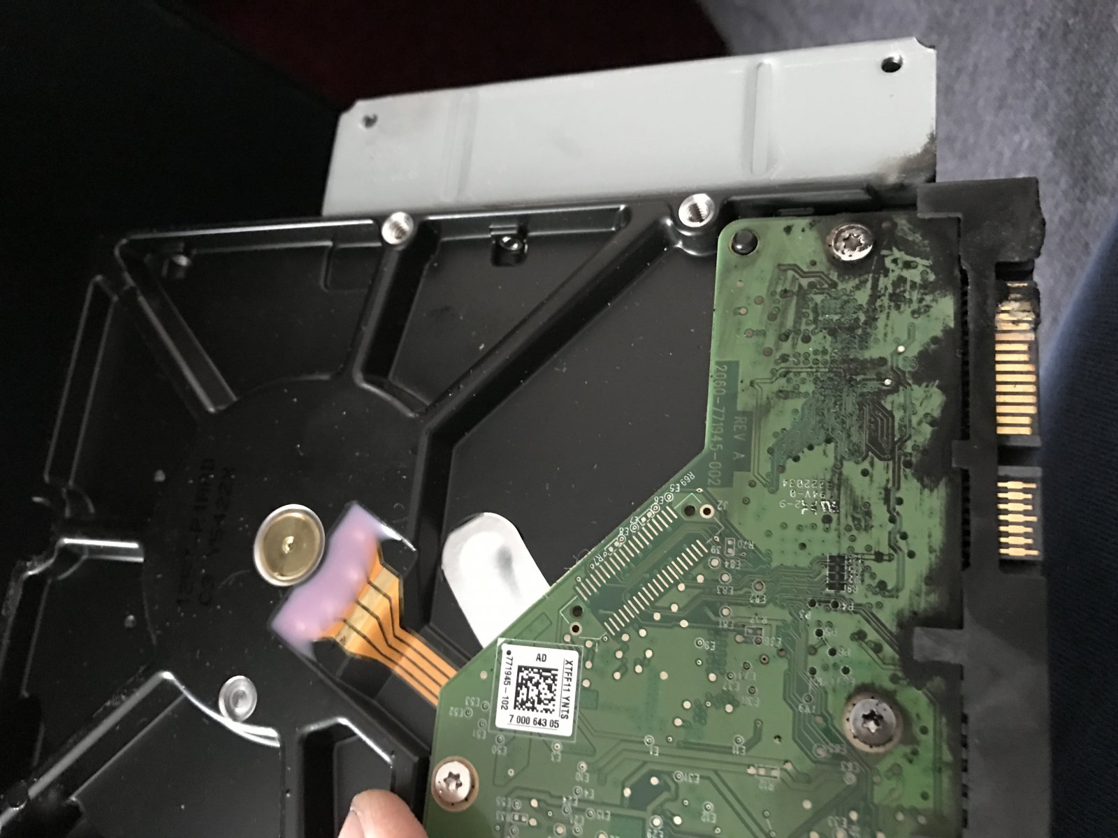

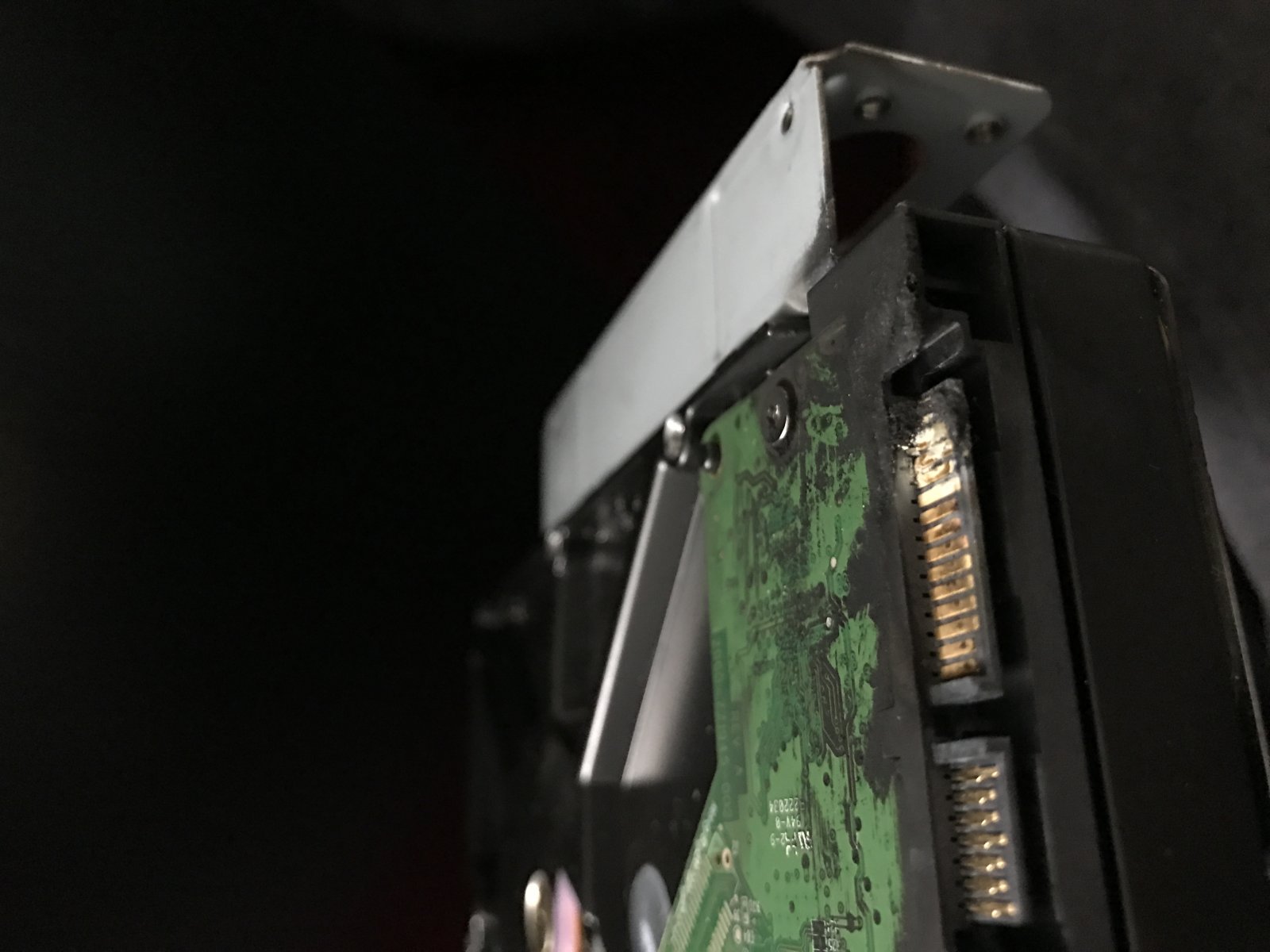

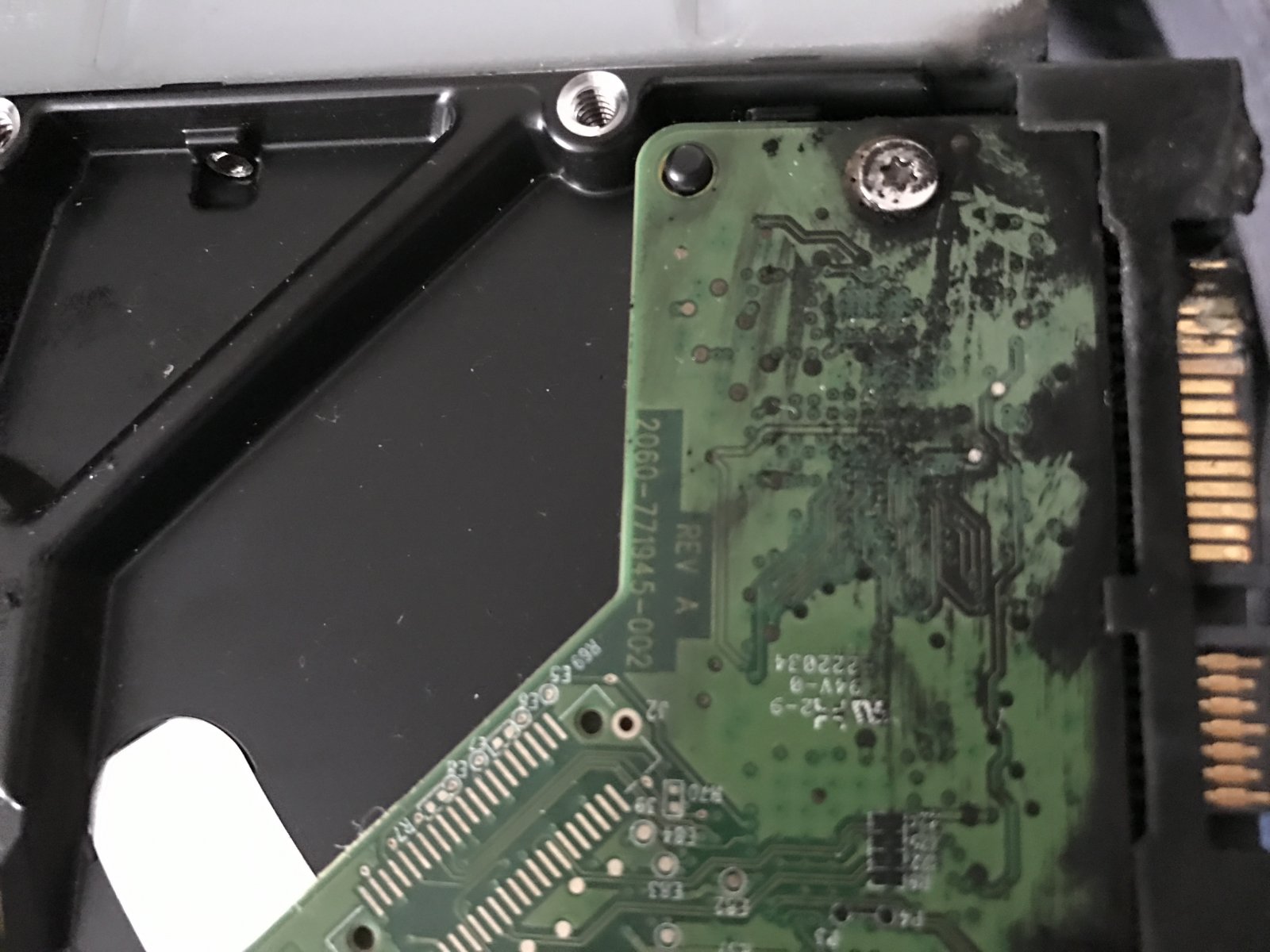

Turned it off to see if i could see what serial no wasn't showing up on the volume list. Hmm probably safe to say i found what the issue was. ( See attachments lol)

15,504
What on earth happened there? I can't tell if it was abraded or if it caught fire. Either way, as you say, a pretty obvious problem. Get a replacement drive, burn it in properly, and replace the failed drive following the manual's instructions. Then make sure your email monitoring is working, your SMART tests are reset to run on the new drive, etc.

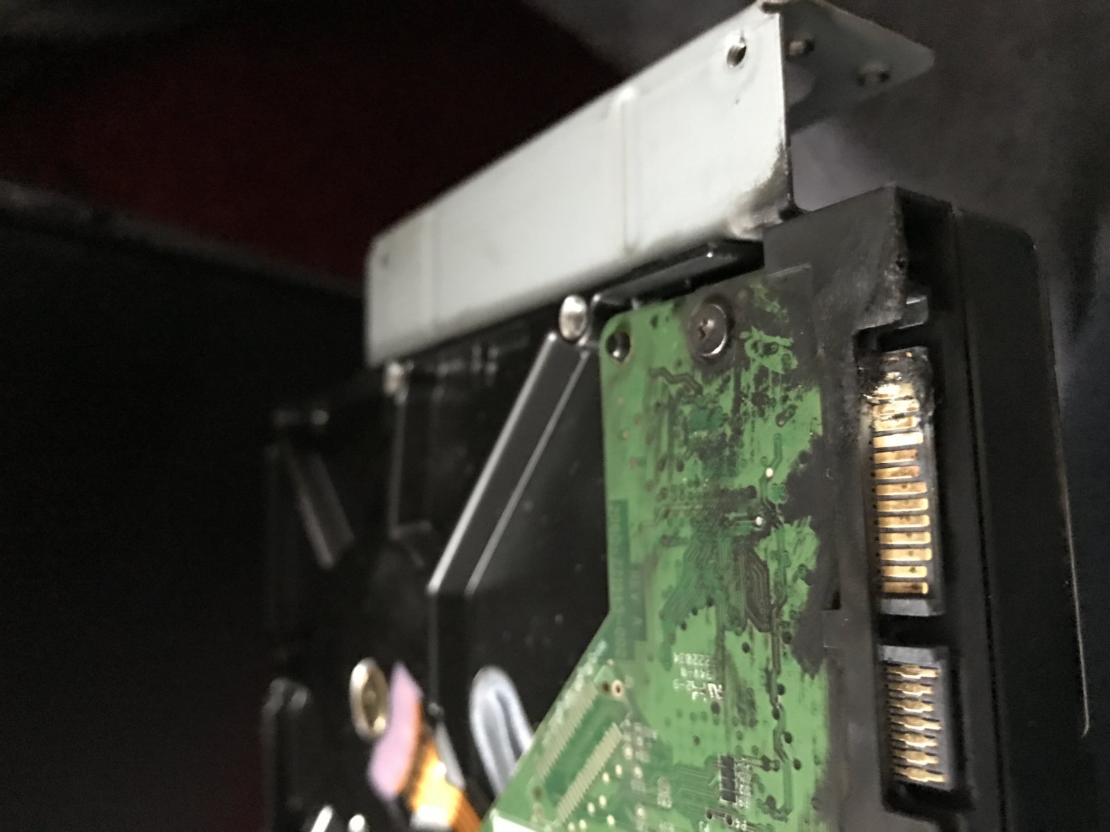

Thank you, It's not burnt but its thick black paste stuff that is hard to get off no idea how it got there. The drive was installed at the top of my define r4 case in a 5.25 to a 3.5inch mounting bracket where there is no dust filters.

Did the drive get too hot?

If it's not soot from burning, it might be toner. Although that amount of it would indicate a major problem elsewhere.

I have pretty good air flow going through the case but that isn't at the top. I was just removing the drives one after another to find the missing one that wasn't showing in the GUI and numbering the drives as i went along to make it easier in the future to find the bad drive.
The drive was some what dusty because there is no bay cover on the front as it interferes with the mounting of the bracket and i flipped it around and saw that. Wasn't on the rest of the drives.

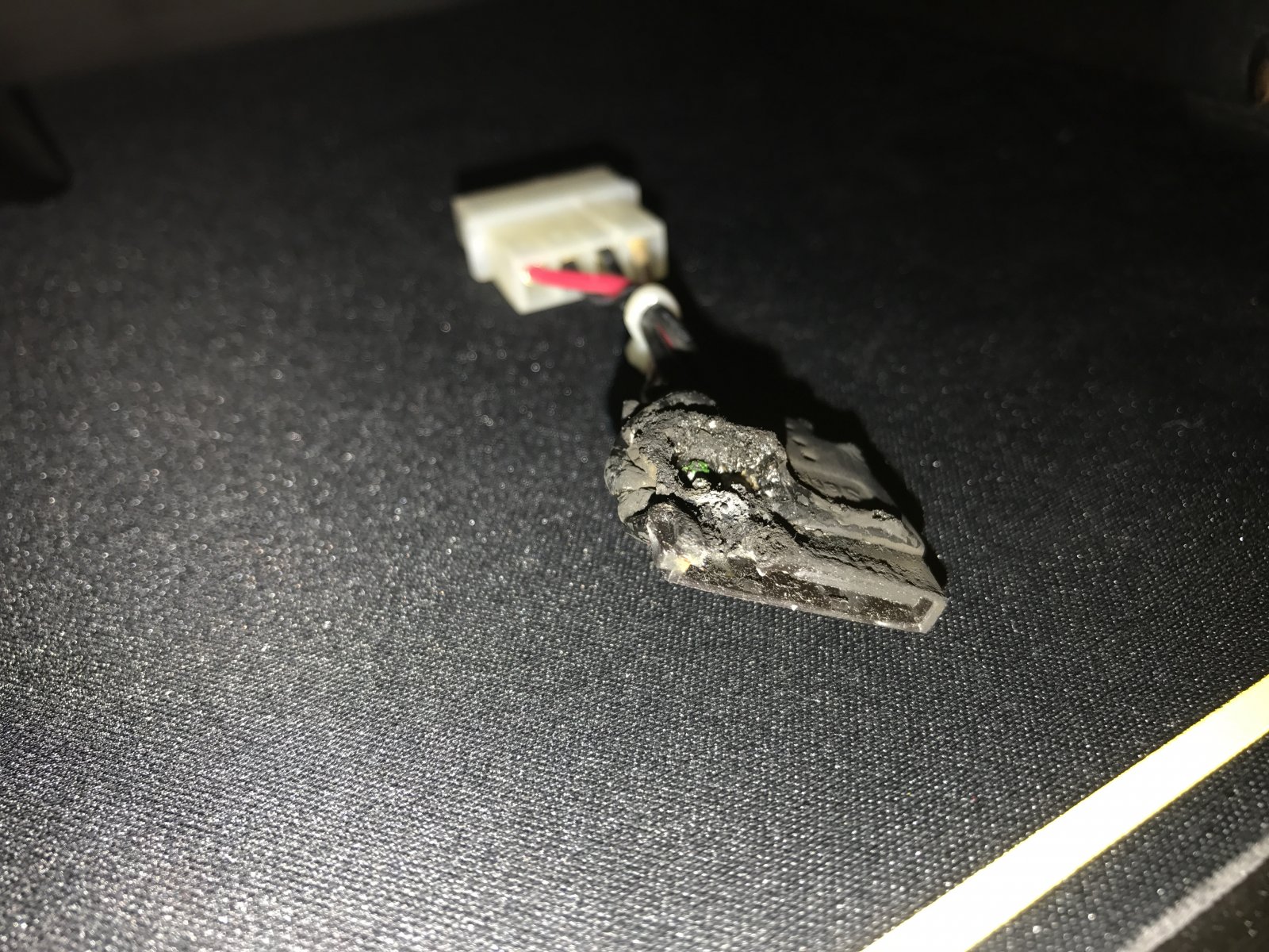

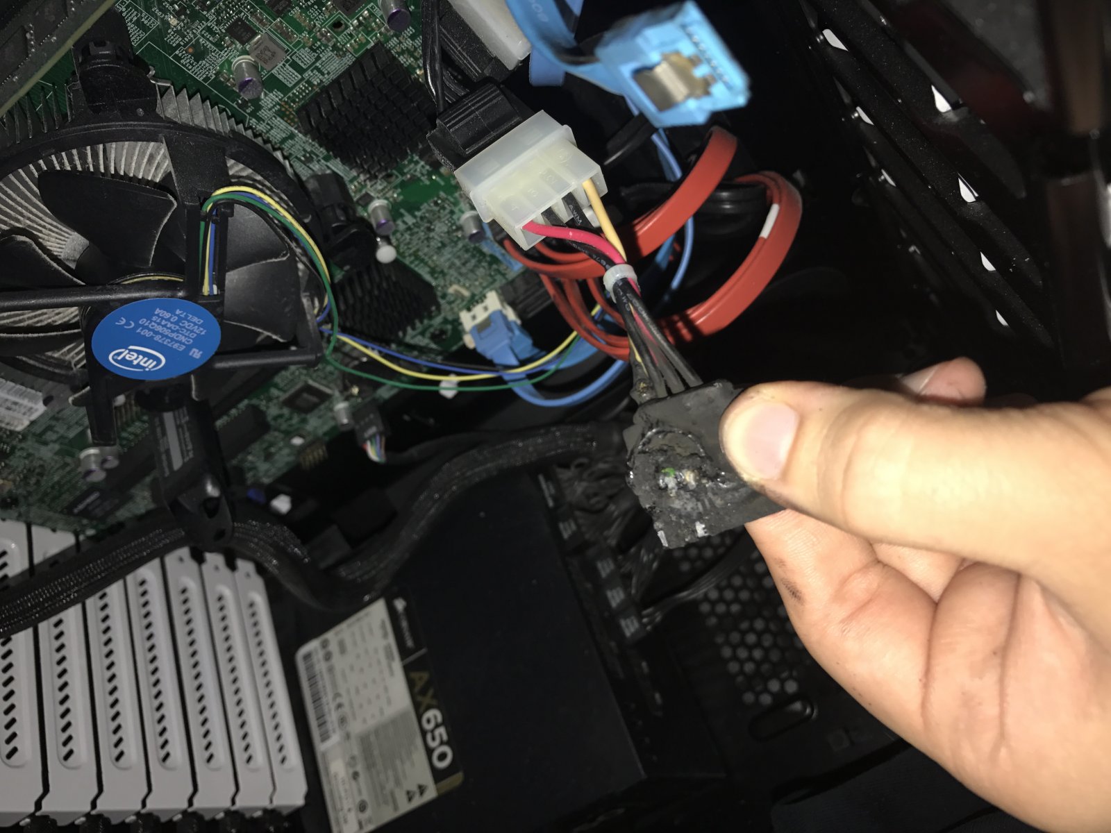

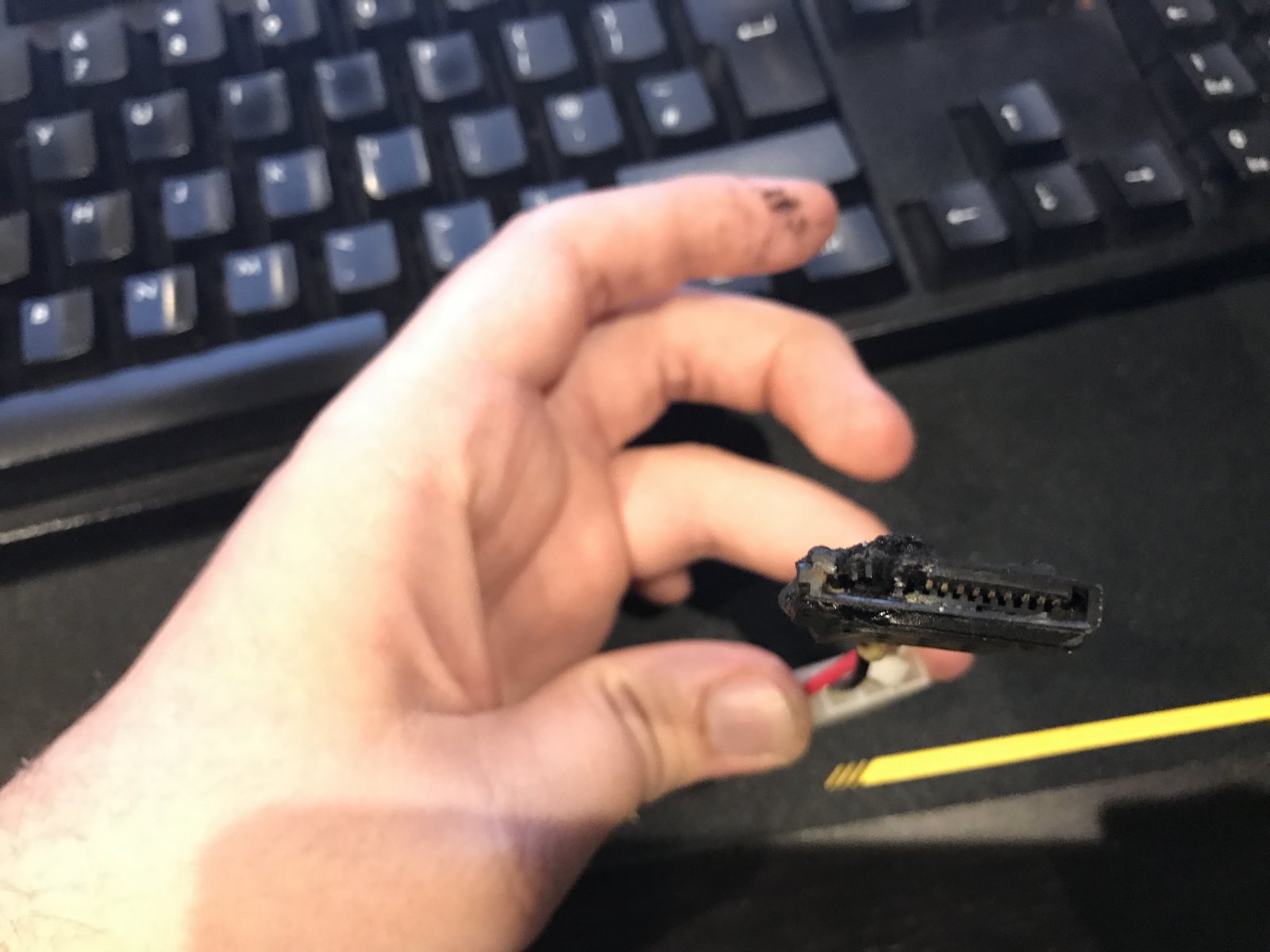

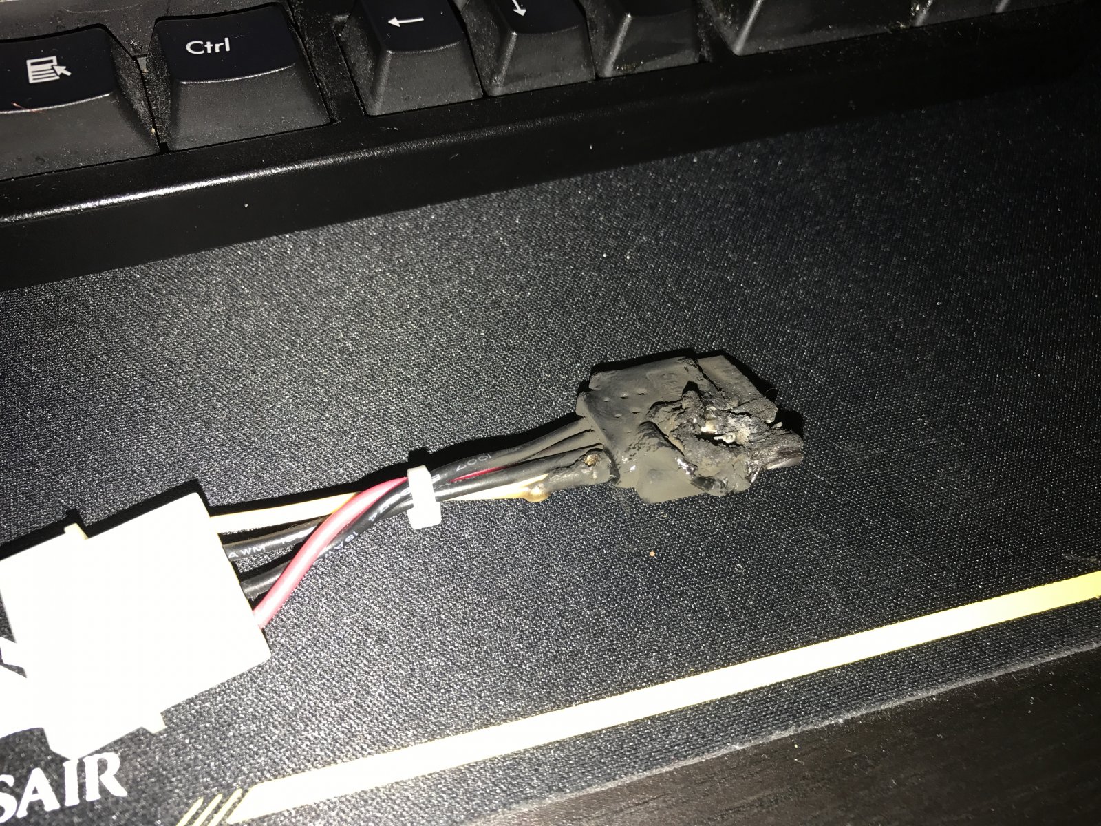

Umm...................... That is not good, good job i went back and checked the connector at least now i know where the black crap is coming from probably burnt up plastic? i touched it and it went all over my hands. That was a molex to sata adapter.

Nope didn't notice it until now, FreeNAS showing as an error from OCT 18th!
Trying to find a reliable adapter but they're all cheap which makes me think it'll just happen again. Any other way to avoid it? I'm already using the SATA PSU cables that came with the PSU for the other 8 drives.

Submitted an Express RMA with corsair and because they don't sell the AX 650 anymore they have upgraded me to an AX 760 which has 12 sata ports instead of 8 so no more adapters needed for drives.
