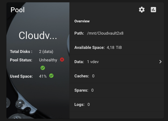

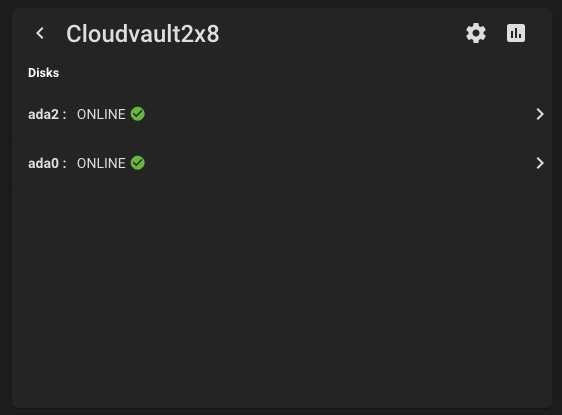

The pool in which the problem occurred consists of two 8TB disks in the mirror.
  1. ada0 – 8TB Seagate Ironwolf ST8000VN0022
  2. ada2 – 8TB Seagate Ironwolf ST8000VN004

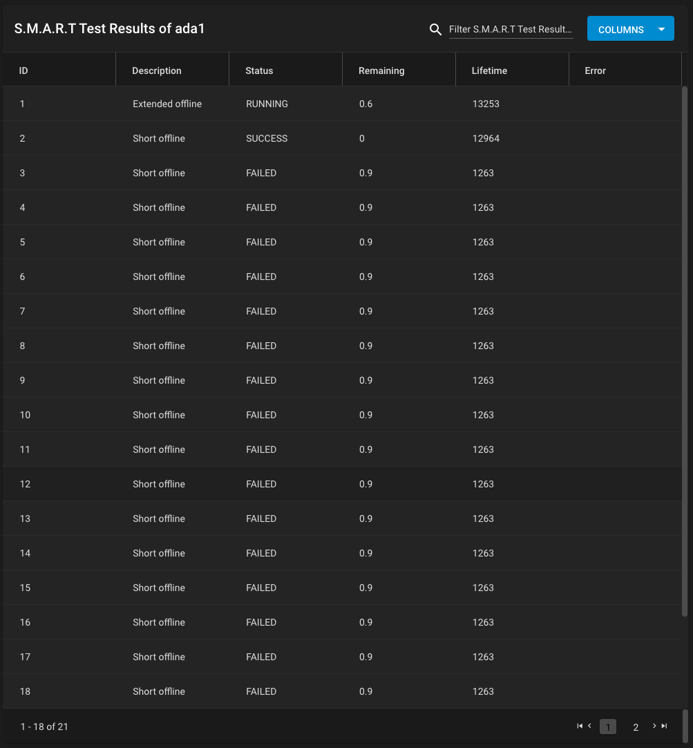

The system is updated to the latest version, the server rebooted, tried to use the methods described here Hard Drive Troubleshooting Guide (All Versions of FreeNAS), but I did not understand if there is something that applies to my case.

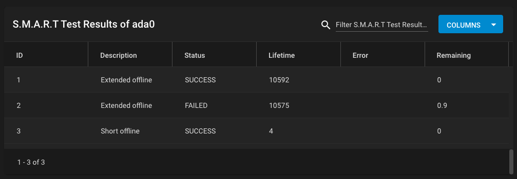

I tried getting SMART from the GUI and got this
ada0 (ST8000VN0022):

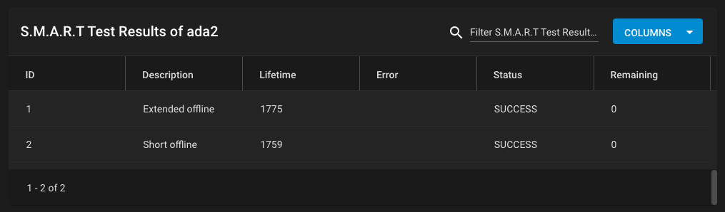

ada2 (ST8000VN004)
Please tell me what is going on and what I need to do to avoid data loss in this pool

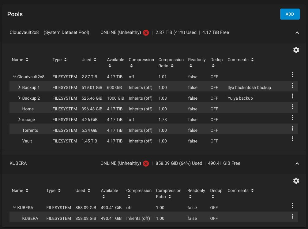

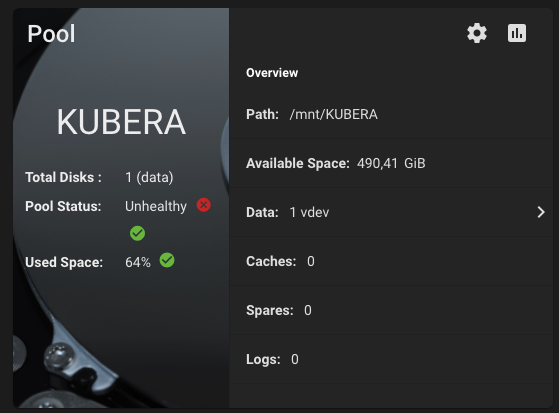

UPD. Today I also noticed that my second pool changed its status to unhealthy. It consists of a single disk. Tests that reached the end-it seems that there were no errors, now I have launched a long test.

You're going to need to move to the CLI for more information.
Try starting with zpool status -v and share the results back here with code tags.
Also you can have a look at smartctl -a /dev/ada0 smartctl -a /dev/ada1 smartctl -a /dev/ada2 and share here in code tags.

Thanks for the answer
root@Cloud Vault[~]# zpool status -v
  pool: Cloudvault2x8
 state: ONLINE
        corruption.  Applications may be affected.
action: Restore the file in question if possible.  Otherwise restore the
        entire pool from backup.
   see: https://openzfs.github.io/openzfs-docs/msg/ZFS-8000-8A
  scan: scrub repaired 384K in 05:53:50 with 10 errors on Thu Feb 11 00:08:06 2021
config:
        Cloudvault2x8                                   ONLINE       0     0 0
          mirror-0                                      ONLINE       0     0 0
            gptid/faee83d5-396b-11eb-8138-408d5c5afa73  ONLINE       0     0 1
            gptid/fb1bf2fb-396b-11eb-8138-408d5c5afa73  ONLINE       0     0 1
        /mnt/Cloudvault2x8/Vault/VAULT/Мультимедия/Изображения/Фото/2014/IMG_20140331_144025.jpg
        <0x11a3a>:<0x2308>
        <0x11a3a>:<0x2226>
        <0x11a3a>:<0x2439>
        <0x11a3a>:<0x1c68>
        <0x11a3a>:<0x1d8e>
        <0x11a3a>:<0x2196>
        <0x11a3a>:<0x1c9d>
        <0x11a3a>:<0x21be>
        <0x11a3a>:<0x20dd>
  pool: KUBERA
 state: ONLINE
status: One or more devices has experienced an unrecoverable error.  An
        attempt was made to correct the error.  Applications are unaffected.
   see: https://openzfs.github.io/openzfs-docs/msg/ZFS-8000-9P
  scan: scrub repaired 0B in 02:12:32 with 0 errors on Sun Feb 21 02:12:32 2021
config:
        NAME                                          STATE     READ WRITE CKSUM
        KUBERA                                        ONLINE       0     0     0
          gptid/428b2f9c-3a4f-11eb-8f83-408d5c5afa73  ONLINE       0    10     0
errors: No known data errors
  pool: boot-pool
 state: ONLINE
  scan: scrub repaired 0B in 00:00:05 with 0 errors on Wed Feb 17 03:45:05 2021
config:
          nvd0p2    ONLINE       0     0     0
root@Cloud Vault[~]# smartctl -a /dev/ada0
smartctl 7.1 2019-12-30 r5022 [FreeBSD 12.2-RELEASE-p3 amd64] (local build)
Copyright (C) 2002-19, Bruce Allen, Christian Franke, www.smartmontools.org
Model Family:     Seagate IronWolf
Device Model:     ST8000VN0022-2EL112
Serial Number:    ZA19RD7B
LU WWN Device Id: 5 000c50 0a5e9e6e5
Firmware Version: SC61
User Capacity:    8,001,563,222,016 bytes [8.00 TB]
Sector Sizes:     512 bytes logical, 4096 bytes physical
Rotation Rate:    7200 rpm
Form Factor:      3.5 inches
Device is:        In smartctl database [for details use: -P show]
ATA Version is:   ACS-3 T13/2161-D revision 5
SATA Version is:  SATA 3.1, 6.0 Gb/s (current: 6.0 Gb/s)
Local Time is:    Tue Feb 23 16:50:19 2021 MSK
SMART support is: Enabled
General SMART Values:
Offline data collection status:  (0x82) Offline data collection activity
                                        was completed without error.
Self-test execution status:      (   0) The previous self-test routine completed
                                        been run.
data collection:                (  567) seconds.
capabilities:                    (0x7b) SMART execute Offline immediate.
                                        command.
                                        Self-test supported.
SMART capabilities:            (0x0003) Saves SMART data before entering
                                        power-saving mode.
Error logging capability:        (0x01) Error logging supported.
Short self-test routine
recommended polling time:        (   1) minutes.
Extended self-test routine
recommended polling time:        ( 800) minutes.
Conveyance self-test routine
recommended polling time:        (   2) minutes.
SCT capabilities:              (0x50bd) SCT Status supported.
                                        SCT Data Table supported.
SMART Attributes Data Structure revision number: 10
  1 Raw_Read_Error_Rate     0x000f   084   064   044    Pre-fail  Always       -       235441344
  3 Spin_Up_Time            0x0003   087   084   000    Pre-fail  Always       -       0
  4 Start_Stop_Count        0x0032   097   097   020    Old_age   Always       -       3456
  5 Reallocated_Sector_Ct   0x0033   100   100   010    Pre-fail  Always       -       0
  7 Seek_Error_Rate         0x000f   092   060   045    Pre-fail  Always       -       1533228957
  9 Power_On_Hours          0x0032   088   088   000    Old_age   Always       -       10868
 10 Spin_Retry_Count        0x0013   100   100   097    Pre-fail  Always       -       0
 12 Power_Cycle_Count       0x0032   099   099   020    Old_age   Always       -       1953
184 End-to-End_Error        0x0032   100   100   099    Old_age   Always       -       0
187 Reported_Uncorrect      0x0032   100   100   000    Old_age   Always       -       0
188 Command_Timeout         0x0032   100   099   000    Old_age   Always       -       2
189 High_Fly_Writes         0x003a   100   100   000    Old_age   Always       -       0
190 Airflow_Temperature_Cel 0x0022   061   049   040    Old_age   Always       -       39 (Min/Max 36/42)
191 G-Sense_Error_Rate      0x0032   097   097   000    Old_age   Always       -       7701
192 Power-Off_Retract_Count 0x0032   100   100   000    Old_age   Always       -       544
193 Load_Cycle_Count        0x0032   001   001   000    Old_age   Always       -       407690
194 Temperature_Celsius     0x0022   039   051   000    Old_age   Always       -       39 (0 19 0 0 0)
195 Hardware_ECC_Recovered  0x001a   010   001   000    Old_age   Always       -       235441344
197 Current_Pending_Sector  0x0012   100   100   000    Old_age   Always       -       0
198 Offline_Uncorrectable   0x0010   100   100   000    Old_age   Offline      -       0
199 UDMA_CRC_Error_Count    0x003e   200   200   000    Old_age   Always       -       3
240 Head_Flying_Hours       0x0000   100   253   000    Old_age   Offline      -       8673 (39 146 0)
241 Total_LBAs_Written      0x0000   100   253   000    Old_age   Offline      -       86322977530
242 Total_LBAs_Read         0x0000   100   253   000    Old_age   Offline      -       162635753846
SMART Error Log Version: 1
No Errors Logged
# 1  Extended offline    Completed without error       00%     10592         -
# 2  Extended offline    Aborted by host               90%     10575         -
# 3  Short offline       Completed without error       00%         4         -
root@Cloud Vault[~]# smartctl -a /dev/ada2
Device Model:     ST8000VN004-2M2101
Serial Number:    WKD1XKCT
LU WWN Device Id: 5 000c50 0d026daae
Firmware Version: SC60
ATA Version is:   ACS-4 (minor revision not indicated)
SATA Version is:  SATA 3.3, 6.0 Gb/s (current: 6.0 Gb/s)
Local Time is:    Tue Feb 23 16:53:22 2021 MSK
                                        been run.
                                        command.
                                        power-saving mode.
recommended polling time:        ( 723) minutes.
  1 Raw_Read_Error_Rate     0x000f   070   064   044    Pre-fail  Always       -       11126240
  3 Spin_Up_Time            0x0003   086   079   000    Pre-fail  Always       -       0
  4 Start_Stop_Count        0x0032   100   100   020    Old_age   Always       -       202
  7 Seek_Error_Rate         0x000f   078   060   045    Pre-fail  Always       -       57301866
  9 Power_On_Hours          0x0032   098   098   000    Old_age   Always       -       2052
 12 Power_Cycle_Count       0x0032   100   100   020    Old_age   Always       -       41
 18 Unknown_Attribute       0x000b   100   100   050    Pre-fail  Always       -       0
188 Command_Timeout         0x0032   100   100   000    Old_age   Always       -       0
190 Airflow_Temperature_Cel 0x0022   062   057   040    Old_age   Always       -       38 (Min/Max 36/43)
192 Power-Off_Retract_Count 0x0032   100   100   000    Old_age   Always       -       16
193 Load_Cycle_Count        0x0032   100   100   000    Old_age   Always       -       729
194 Temperature_Celsius     0x0022   038   043   000    Old_age   Always       -       38 (0 19 0 0 0)
195 Hardware_ECC_Recovered  0x001a   070   064   000    Old_age   Always       -       11126240
199 UDMA_CRC_Error_Count    0x003e   200   200   000    Old_age   Always       -       0
240 Head_Flying_Hours       0x0000   100   253   000    Old_age   Offline      -       1869 (215 125 0)
241 Total_LBAs_Written      0x0000   100   253   000    Old_age   Offline      -       18110565290
242 Total_LBAs_Read         0x0000   100   253   000    Old_age   Offline      -       14397691178
No Errors Logged
# 1  Extended offline    Completed without error       00%      1775         -
# 2  Short offline       Completed without error       00%      1759         -
root@Cloud Vault[~]# smartctl -a /dev/ada1
Model Family:     Seagate Barracuda 7200.14 (AF)
Device Model:     ST1500DM003-9YN16G
Serial Number:    S24083A6
LU WWN Device Id: 5 000c50 04a900b54
Firmware Version: CC4C
User Capacity:    1,500,301,910,016 bytes [1.50 TB]
ATA Version is:   ATA8-ACS T13/1699-D revision 4
SATA Version is:  SATA 3.0, 6.0 Gb/s (current: 6.0 Gb/s)
Local Time is:    Tue Feb 23 16:56:03 2021 MSK
==> WARNING: A firmware update for this drive is available,
see the following Seagate web pages:
http://knowledge.seagate.com/articles/en_US/FAQ/207931en
http://knowledge.seagate.com/articles/en_US/FAQ/223651en
                                        been run.
data collection:                (  600) seconds.
                                        command.
                                        power-saving mode.
recommended polling time:        ( 205) minutes.
SCT capabilities:              (0x3085) SCT Status supported.
  1 Raw_Read_Error_Rate     0x000f   114   099   006    Pre-fail  Always       -       75706848
  3 Spin_Up_Time            0x0003   093   092   000    Pre-fail  Always       -       0
  4 Start_Stop_Count        0x0032   081   081   020    Old_age   Always       -       20126
  5 Reallocated_Sector_Ct   0x0033   100   100   036    Pre-fail  Always       -       0
  7 Seek_Error_Rate         0x000f   047   044   030    Pre-fail  Always       -       1477484217272
  9 Power_On_Hours          0x0032   085   085   000    Old_age   Always       -       13258
 12 Power_Cycle_Count       0x0032   098   098   020    Old_age   Always       -       3006
183 Runtime_Bad_Block       0x0032   001   001   000    Old_age   Always       -       1469
187 Reported_Uncorrect      0x0032   098   098   000    Old_age   Always       -       2
188 Command_Timeout         0x0032   100   100   000    Old_age   Always       -       0 0 0
189 High_Fly_Writes         0x003a   095   095   000    Old_age   Always       -       5
190 Airflow_Temperature_Cel 0x0022   066   050   045    Old_age   Always       -       34 (0 1 37 32 0)
191 G-Sense_Error_Rate      0x0032   100   100   000    Old_age   Always       -       0
192 Power-Off_Retract_Count 0x0032   100   100   000    Old_age   Always       -       994
193 Load_Cycle_Count        0x0032   042   042   000    Old_age   Always       -       117524
194 Temperature_Celsius     0x0022   034   050   000    Old_age   Always       -       34 (128 0 0 0 0)
199 UDMA_CRC_Error_Count    0x003e   200   200   000    Old_age   Always       -       907
240 Head_Flying_Hours       0x0000   100   253   000    Old_age   Offline      -       4549h+38m+05.168s
241 Total_LBAs_Written      0x0000   100   253   000    Old_age   Offline      -       56749194385815
242 Total_LBAs_Read         0x0000   100   253   000    Old_age   Offline      -       124959309593570
No Errors Logged
# 1  Extended offline    Completed without error       00%     13255         -
# 2  Short offline       Completed without error       00%     12964         -
# 3  Short offline       Aborted by host               90%      1263         -
# 4  Short offline       Aborted by host               90%      1263         -
# 5  Short offline       Aborted by host               90%      1263         -
# 6  Short offline       Aborted by host               90%      1263         -
# 7  Short offline       Aborted by host               90%      1263         -
# 8  Short offline       Aborted by host               90%      1263         -
# 9  Short offline       Aborted by host               90%      1263         -
#10  Short offline       Aborted by host               90%      1263         -
#11  Short offline       Aborted by host               90%      1263         -
#12  Short offline       Aborted by host               90%      1263         -
#13  Short offline       Aborted by host               90%      1263         -
#14  Short offline       Aborted by host               90%      1263         -
#15  Short offline       Aborted by host               90%      1263         -
#16  Short offline       Aborted by host               90%      1263         -
#17  Short offline       Aborted by host               90%      1263         -
#18  Short offline       Aborted by host               90%      1263         -
#19  Short offline       Aborted by host               90%      1263         -
#20  Short offline       Aborted by host               90%      1263         -
#21  Short offline       Aborted by host               90%      1263         -
riddle0
Feb 11, 2021
4
I also forgot to specify that some of the files stored on the disk were copied from a dead HDD, maybe that's why it refers to the fact that some files are damaged. But they have been stored there for a long time and before the status of the pool was normal
riddle0
Feb 11, 2021
4
What cotroller are you using? Are these USB drives or eSATA via a PM?
The 3.5" drives are connected directly to the NAS motherboard's SATA ports. The SATA controller is standard for the Z170 Intel chipset. I do not use a hardware raid, but use a mirror one created inside TrueNAS
ZFS is not a backup.
I use zfs pool as the main file storage, so I created it in the mirror for safety
Yorick
Nov 4, 2018
1,912
Raw read error rate is high. If that keeps going up, it looks like all three disks are failing.
CloudVault unfortunately has metadata errors. If you don't have a backup, get the data off *now* that you can. You may need to rebuild the pool if these metadata errors can't be resolved.
