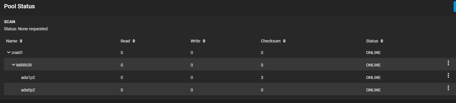

Yesterday I first time installed this system for my 2 new 4tb drives. Still copy data to my new NAS storage.
Using Truenas CORE 12U1.
Today I have alert:
Pool zraid1 state is ONLINE: One or more devices has experienced an unrecoverable error. An attempt was made to correct the error. Applications are unaffected.
2020-12-20 15:21:50 (Europe/Moscow)
and Pool status on dashboard is unhealthy.
What I should do next? where and what to check

For example if you are running 4GB RAM, that could be the cause of your issue
Im running 3gb RAM. with mirrored pool 4gb+4gb WDC WD40EZRZ-22GXCB0 (no SMR). One disk have checksum errors:
Why 8gb ram needed for simple hard disk operations + web interface?
The operating system needs this much RAM in order to work effectively. With low RAM situations the system will SWAP out RAM to the hard drive so it can run an application/function, then when the RAM is free or just needed again the stuff pushed to the hard drive will be reloaded, and that could mean something else it removed from RAM and placed on the hard drive. So you need to have enough RAM to make it work well. Constantly using the SWAP space means your hard drives take a beating and everything slows down. If you enabled any extra features like Plex or other VM/Jail programs, your situation would be unsustainable with 3GB RAM.
You can also check your SWAP space to see what has been used. It should be a Zero value. On the GUI (I'm using FreeNAS 11.3U5) and it should be similar layout, select the Dashboard -> Pool -> Disk Reports -> On the drop down select MEMORY and scroll down to SWAP Utilization. At the bottom of the chart it should say "Used" and Min/Mean/Max. All three values should be "0". Having a few very small values is not terrible, any value other than zero indicates you are short on RAM.
If you are looking for a NAS program that will run on less RAM then you could use an older version of FreeNAS or check out NAS4Free but I think they desire 4GB RAM minimum, I could be wrong.
But check the SWAP Utilization value and also check your hard drives out. I'd run a SMART Long test on them and then check the results. If all is good then they are unlikely to be your issue.
