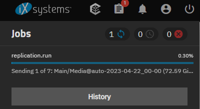

I started working with it today not sure where things went wrong. I ended up deleting all of the snapshots from both servers, then went back into the main (dell) UI and re-created the replication task using the exact same setting as before. when I attempted to run it manually the first time, it failed with an error showing it could not un-mount the pool from the backup server.
I stopped there and rebooted both servers and tried to run it again. this time I did not log into the backup servers web ui. something I didn't think about is the main server has a user account for me to log into that is not root. on the backup server, I had never made another account and was using root to login to the web ui.
watching the task I can see that it is sending snapshots to the backup server and is slowly progressing but when I open the folder in windows, specifically the one that has the music stored on it from the backup server, it is empty now. I am assuming that it is transferring data and since it transferring in blocks, the files in that folder are not readable yet. I did not check the box to overwrite any existing data in the replication task but I assume it all would show up once the task is complete.
at the moment this is what I am seeing but time will tell if it is actually working

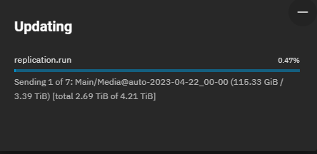

looking at this I am assuming it it sending the entire media folder to the backup server rather than just the files that are not present there? over 3tb of data?
