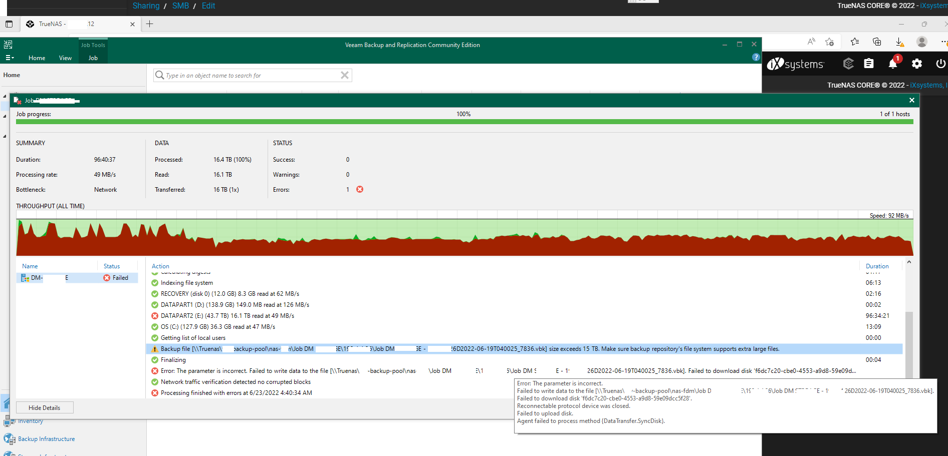

I am trying to use a zfs raidz2 pool as repository for Veeam, i have a backup of a physical server to do.it has already failed (after 5 days of data transfer) because the single file size exceeds the 15tb.

Hi Sretalla thanks for your reply.
The error message is from Veeam, so the copying tool, not from Truenas.

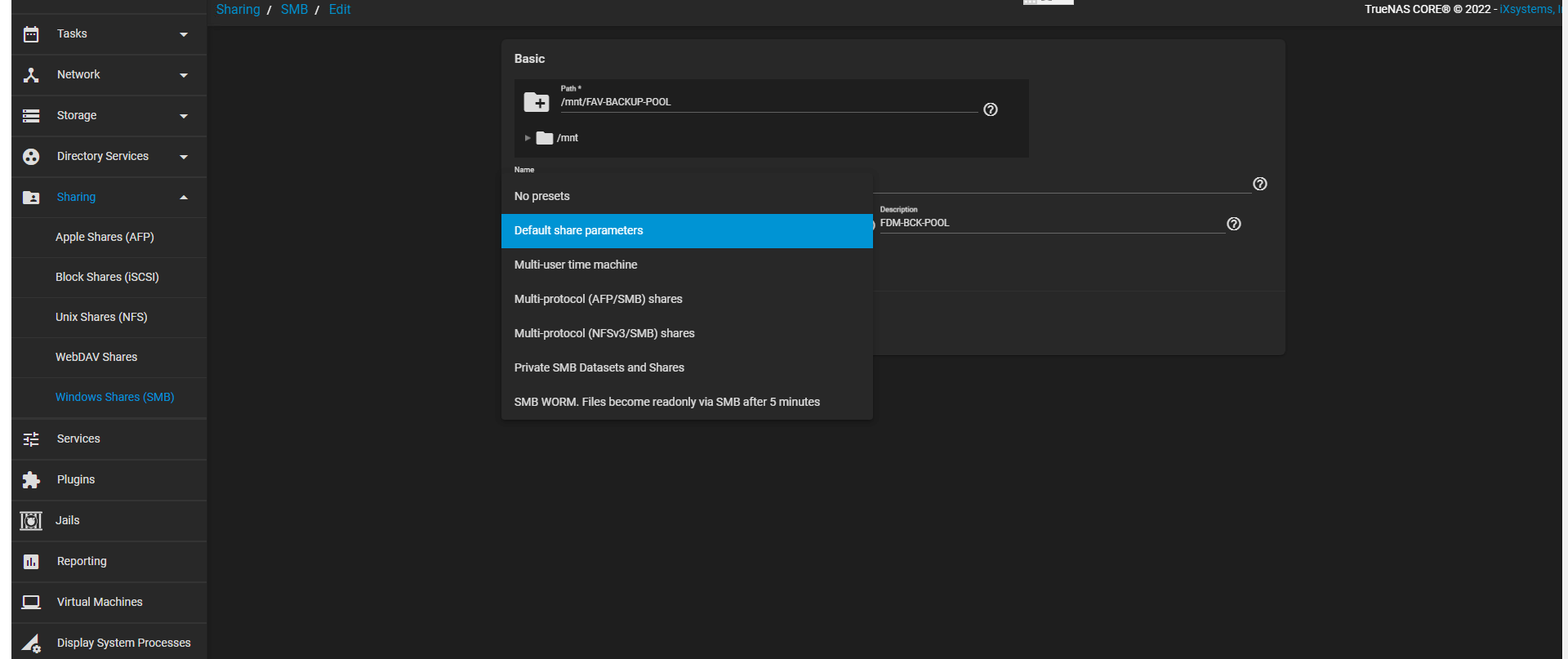

could it be because of the share parameters set to "default" - maybe i have to pick some other paramenter?
couple screenshot attached.
Thanks again for your time, much appreciated!

Asked on Veeam forums and they said:
"Many of similar storages as TrueNAS have some limitations independent from the used filesystem maximum file sizes. So please reach out to the TrueNAS vendor"
