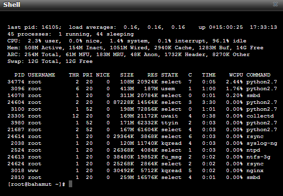

thanks. okay but which one of these correlates to my import disk and copy command? sorry im really new to non-windows stuff.
