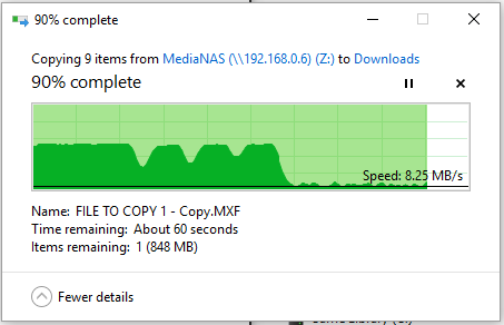

This is the image referring to the random drop in speed I got last night.
I think I had started with 10 X 1GB files, and the more it transferred the slower it got. Any reason?

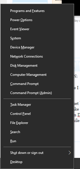

SOLUTION:
Ok so since I can't seem to find that option in the BIOS anymore this is the solution I offer to anyone else having this issue:
  • Reset both BIOS settings for Server (FreeNAS) and Client (Windows 7/10 machines).
  • Make sure your NIC drivers are up to date. Maybe even uninstall and reinstall them.
  • Run DBAN on the HDDs you are going to use for the RAID array so they are fully wiped and clean. DBAN will also alert you of drive issues if any of your HDDs have issues.
  • I won't go into how to use DBAN as they are many great videos (also it's super simple), but for our needs doing the "Quick Format" option is more then enough
  • While DBAN is running on the NAS, on your Windows machine press "Windows + x". A menu should pop up, see Pic #1.
  • Click on "Command Prompt"
  • Click "Windows + x" again and click on "Disk Management"
  • In Disk Management locate the USB device you want to install FreeNAS too and the USB you want to use as the installer for FreeNAS. Take a note of the Disk number. DO NOT MESS THIS PART UP.
  • Go to the Command Prompt
  • Type in diskpart
    • Click yes on the pop up asking for permission, a new window should pop up, the typing will be in the new window from now on
  • Type "list disk" and make sure your USB device shows up
  • Type "select disk x", x being the disk number of the USB. Do one USB at a time. A dialog should output saying "Disk X is now the selected disk"
  • NOW MAKE SURE YOU HAVE THE RIGHT DISK SELECTED AS THIS NEXT STEP WILL COMPLETELY WIPE THE DATA OFF
  • Type "clean"
  • If you go back to Disk Management your USB should now be a black empty space.
  • Doing all this is very helpful if you ever formatted your USB on a Mac OS or Ubuntu where Windows can not delete HFS partitions and such.
  • Do this to both the USB you are installing the FreeNAS installer and to the USB you are actually installing FreeNAS too.
  • Now install FreeNAS on the cleaned USBs.
  • While DBAN is still running or FreeNAS is installing do "windows + x" again.
  • Go to "Device Manager"
  • Expand "Network Adapters"
  • If you haven't updated it yet, do that now.
  • Right click your NIC and click properties
  • At the top, click "Link Speed"
    • The settings here are very similar to what I found in my BIOS before and couldn't later.
  • Where it says "Speed and Duplex" it might say something like "Auto Negotiation"
  • Click that and select "1.0gbs Full Duplex" (your option might say 1000mbs Full Duplex"
  • Restart computer to make sure it fully took effect
  • You should now no longer have the weird issues I was getting were the NIC would crashing going 1gbs between the Server and Client.
I hope this helps and that this guide is at least semi clear. I have marked this forum SOLVED but if you have questions feel free to ask.
