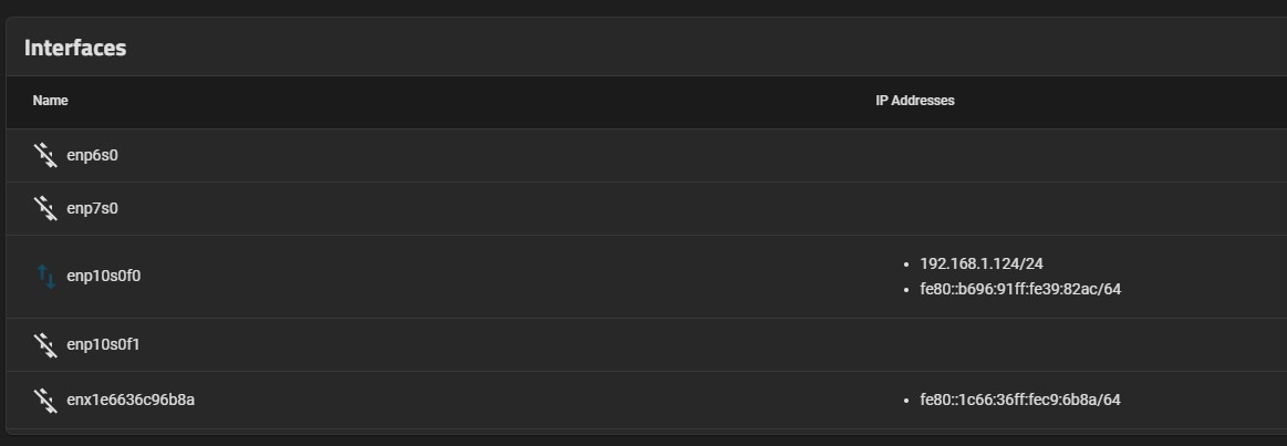

Thanks, yes here is the screenshot attached. enx1e6636c96b8a is the IPMI card. As you can see, Truenas Scale picked up the the card and was able to display the MAC address but not the static IP address. I set the static IP address for this IPMI card in the bios and this card is physically connected to the network and I access the IPMI card via a browser in Windows. I can hit the trash can button to remove it, but it will come back up when I reboot the truenas scale box. Please shed some light on how to disable / remove it within Scale. I can't disable the IPMI card in bios because it will disable the card entirely.
I also ran the ethool and here is some info.
Feel free to report as a bug. My guess is that the intention should be for the interface tio be trashed persistently.
It might be fixed in 2.12.2.. you could wait to test that.
A temporary solution would be to do an init script.

I checked again and confirmed that the trash button doesn't get rid of of that IPMI network interface permanently. It just comes back and yes, I will report as a bug.
As for the temporary solution, what command should I apply for the initial script? Linux is still a territory that I'm exploring. Thank you

It should be feasible, but I don't know the specific command either... perhaps someone else will know.
