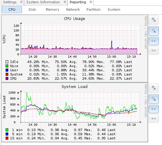

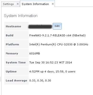

Dear all,
I'm trying to make freenas box on my office, using dual core pc and 6gb ram,
is it ok ? or not good ? or not recommended ? i need some advice .
i'm planning to change from dual core to i3 and 8gb ram .. but for now .. i'm running with this spec.
This freenas will be accessing for 60-80 user . with data direct load from freenas, the data mostly is excel file and some drawing file like .dwg.
please give me some advice
system information and reporting's attached .
Thanks n regards,

60-80 users without even meeting minimum requirements? That's insane. It sounds like you're not planning on ECC either, which is equally insane in an office setting.
At the very least, you're looking at a variation of the typical i3 43xx, Supermicro motherboard and 16GB of ECC RAM as an absolute baseline. Even then, performance may be unacceptable.

Well, considering you aren't even meeting the minimum requirements, it's "not good"....
If you read the hardware requirements section of our documentation it says 8GB minimum, regardless of pool size and/or the number of users.
Edit: With 60-80 simultaneous users you are certainly going to want 16GB at the minimum, and perhaps more. With 60-80 simultaneous users I'd recommend nothing less than 24GB of RAM, with 32GB of RAM being a better option.
